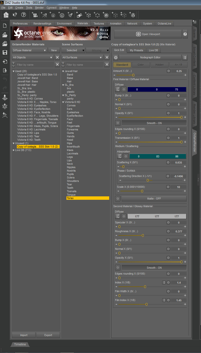

I just purchased the new 2.x plugin for Daz, and am really confused on how to properly implement material from Live DB.
I am specifically trying to use "icelaglace's SSS skin 1.0" with a Victoria 6 HD model.
When I copy in the material in, I am met with these options (see screenshot 01), after hitting the small button next to the 'nodegraph editor' I am met with more options (see screenshot 02).
After playing around with it a little, I am still confused which properties from screenshot 2 do I change, and have them linked as either a floatimage, RGB image, or whatever it is called now to the proper color, bump, and specular maps.

by SiliconAya
Looking at the material in standalone, most of the stuff you want to replace is in the 'Second Material / Glossy Material', put a skin texture in a RGB color map in diffuse and the spec and bump maps in grey maps in specular and bump (you'll also need to change the power setting of both the spec and bump depending on how they turn out, but as a guess I'd set spec power between to 0.7-1.0 and bump between 0.05-0.075).
In the 'First Materials' I'd change Scale under 'Medium / Scattering' from 10 to at least a 100 (this will probably need to be further tweaked), other than that I'd leave the rest as they are for the moment.
This is all very basic to get you up and running with a result that should at least look OK, though I've never used this material so I'm unsure what can be done with it. Once you've done this much change around some of the settings and see/learn what they do, with roughness in the 2nd material being another important one to look at, as it controls how glossy/wet the skin will look if you wish the change that.

by sikotik13
It would be neat to have a video in theory, but since the materials themselves vary highly in their construction, it would still come down to getting into the materials and playing around with thing to figure out which you prefer for what and why. Aya's recommendation is probably your best bet, with the addition that if you are a visual learner, the NGE (Nodegraph Editor) itself is likely to be helpful in seeing how things connect together. It's more like assembling a material in the standalone, from what I remember, and changed how I alter materials entirely. I honestly only use the quick edit to alter RGB values and maybe bump strength, everything more complex, I just open the NGE.
