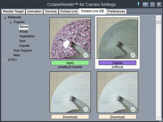

The revamped LiveDB tab is now available. With this version you can browse the LiveDB catalog before downloading the material. Also, when you download a material it gets added straight into the Carrara project as a new Master Shader. You can no longer download to disk but you can always manually save the shader from within Carrara. If you have previously downloaded the LiveDB catalog, feel free to delete it or keep it as you see fit.
You can also Apply downloaded materials using the Octane Viewport. To do this, click on the Apply button after you have downloaded a material. Now, whatever you click on in the Octane viewport will get the new material. You can also right click to get a list of stacked materials. Select an item in the list to apply the material. To exit Apply mode either click on the Cancel button in the LiveDB tab, apply a different material or press the <ESC>ape key.
Some things to note.
Instances of a mesh that share the same master shader will be affected as a group. Use Carrara if you want to shade individual instances separately. Also, once you download a shader it will remain linked to the Octane LiveDB tab until you either edit or delete the Master Shader. If you edit a shader then you will not be able to apply the shader from the Live DB tab until you download a new original first.
Octane Live DB
Octane Live DB
