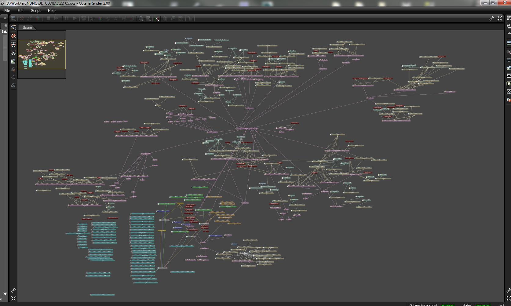

Hi I am having a difficult time with the new release, here are a list of comments and problems I find.
1. I organize my models into many groups and components, but when i export the models i get this with many instances, is there a way to organize it with just materials where the whole model is export as 1 obj file? (pls see screenshot)
organization
organization
2. geometries/materials often dont sync up with octane viewport after hide/unhide, cut/paste several times
3. material with texture does not sync up with octane viewport when i change rgb/hsl values within sketchup's material editor.
4. stability issue, both sketchup and octane 2.0 crashes way more often compared to version 1.2(where i am coming from) see screenshot. Also sketchup seem to run much slower with the octane viewport active sometimes
organization
organization
bug1
bug1
5. Material editor for octane within sketchup is a pain to use (text too small, parameters missing), I understand that it is said that octane standalone is a compliment and i am suppose to edit materials there but isn't now i have to go back and forth between sketchup and octane render, which defeats the purpose of the plugin of not having to go back and forth.
6. Cannot use octane sun with the plugin? it's very hard to tweak the sun's position with sketchup or the plugin (no turbidity, latitude...etc). I consider sun position one of the most important factor in tweaking my renders
7. no localDB with the plugin?
that's all i can think of for now and i guess i have to go back to 1.2 for now. Please excuse my poor english.
It's not a bug, it is how geometry and groups are stored inside SketchUp plugin. It might be hard to navigate when you have a lot of components so I recommend exploding geometry to a single mesh and then export it .ocs
1. Do you mean I have explode everything in the sketchup model into a single mesh? This would not work for me as once geometries are exploded it is very hard to edit it afterwards. For now I use TIG's exporter and it worked fine and I don't need to explode the model, but then it's slow in exporting. Is there a way to export the model in similar fashion of that of TIG's exporter with the in plugin? just an exporter same as TIG's exporter but faster would be great

Hello again mate, I have downloaded your scene and tested a bit.
Well as I said, for example in your scene I would put furniture in 1 layer, building in another and decoration in a 3rth layer, then it would be easier to model/adjust/tweak everything.
One question, do you want to work/render final images inside Sketchup or you want to teak everything in SU and then save to .OCS and render in StandAlone?
Lets take this project as an exemple :
Option 1: (modeling/exporting as obj)
if you export everything as .obj (with TIG exporter) you have a .obj node with more then 50 materials. Then in StandAlone you would teak all of them. If any change in need in the model you go back to SU, edit and export again the .obj and refresh.
Option 2: (modeling/exporting as obj, Diferent Parts)
You export diferent parts (selections) of your project and then use a Group node in StandAlone to join them. When you have to change something you go to SU edit that object and them export as .obj the part you edited. Then refresh.
Option 3 (with plugin)
You do everything inside SU, use Octane Plugin to edit materials, lights, everything. Render Final images inside SU. If you want you save all project to .OCS format and open it in StandAlone. (a big mess of nodes) but everything you did in SU is there, all materilas, light, etc etc are there (that is amazing)
Now the question here is....would be great to have the otion to export to .ocs as a single mesh? YES (and I belive Fuzzy will find a way to give us that amazing option "save to .ocs exploded" :twisted: , but for now this is what we have with the limitations of Sketchup memory.
Another thing that maybe Fuzzy manage to do is "Save to .OCS without geometry" and all settings , all materials, would be saved to .OCS and then we just need to export the scene as .Obj and load it in Standalone.
But all this option are only valid if you really need to go to StandAlone (for now... we do need because we miss some features)
To solve the problem of messy number of nodes (that plugin needs to do to save memory and fight the 32bit limitation of Sketchup), you can do a few things.
Export to .OCS - open StandAlone, erase all mesh, material and scatter nodes, and keep the material, camera, kernel, etc etc - save
In SU export project as .OBJ - load the .OBJ file and connect materials.
If you name your materials you easily set your project up and running in StyandAlone. 10 minuts max and its done you converted a big project(all edited with Octane magic) from SU to StandAlone without explode anything
