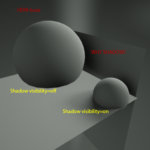

Thanks Jimstar for your great effort, most of my scenes work with the new plugin right away.
But I guess there is a bug, when using hdri and disable shadow visibility. In following example the bigger sphere shouldn't generate any shadows, but does with my hdri.

cyrillweiss wrote:Thanks Jimstar for your great effort, most of my scenes work with the new plugin right away.
It is how Octane engine works...
