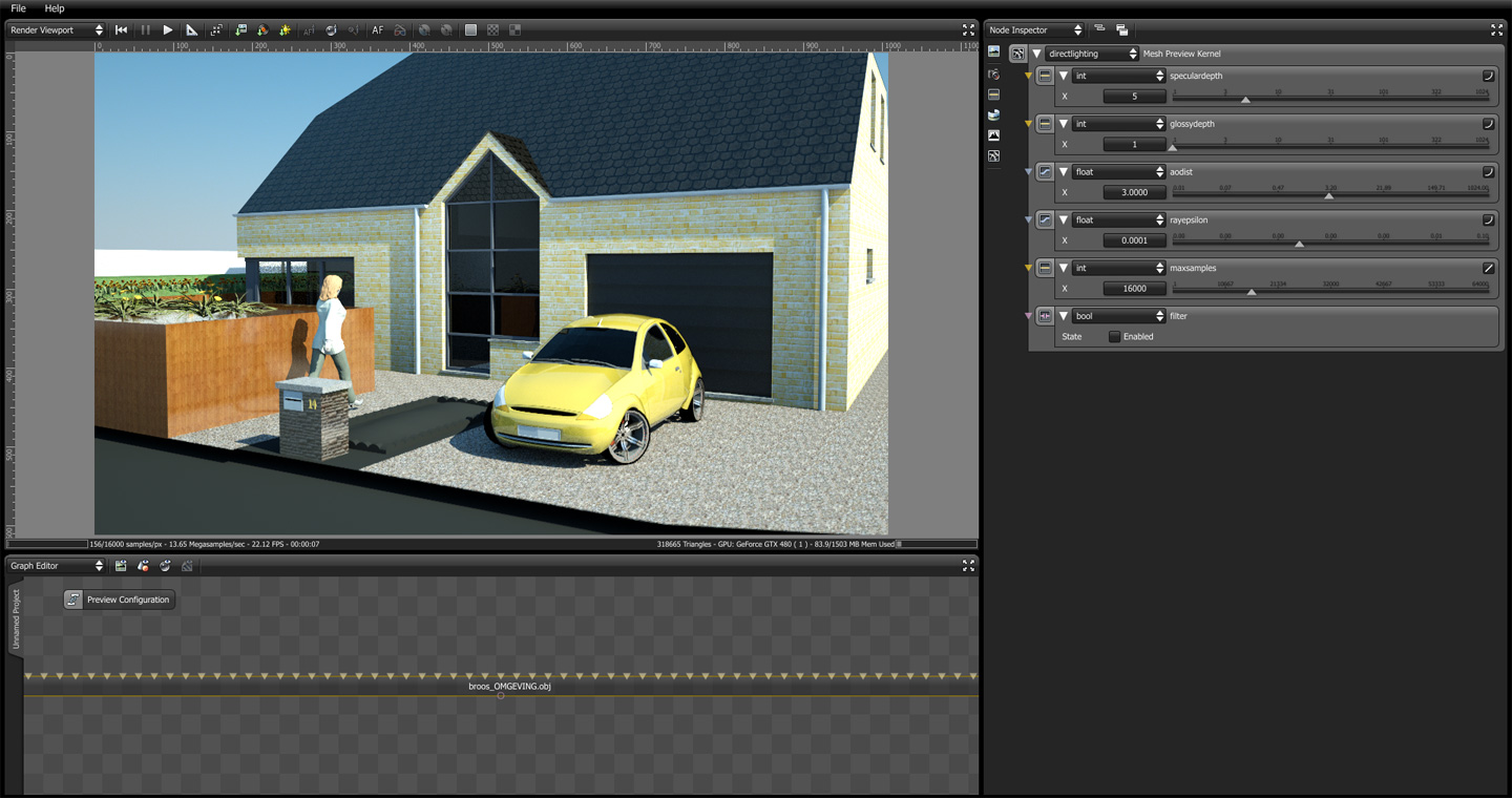

Some shots, the original sketchup file and plugin with defaults:
original sketchup scene, octane plugin loaded with defaults, and i hit the render button
What it looks like in octane once the plugin has exported and launched octane:
Default imported materials/textures from sketchup, this what appears after sketchup starts octane
Final result, just 1 minute (with one GTX480 GPU), made a few small tweaks (not enough), this model is very light so i get a very high FPS and smooth navigation.
result, 1 minute tuning, 7 second render
