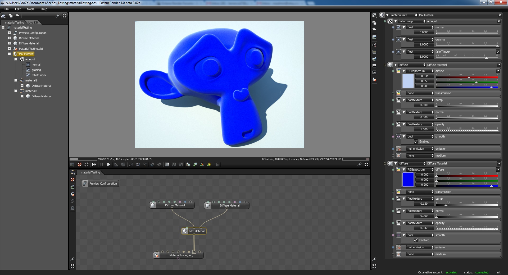

Very interested in cloth example with falloff. What node of (diffuse?) material should I connect falloff node output to get same effect?
Re: Falloff node - Simple HOWTO
Posted: Sun Oct 07, 2012 8:31 pm
by FooZe
Hi andw,
Use a mix material and then use the falloff node for the mix amount.
Something like this:
With that you can control exactly what both the straight on and grazing parts will look like.
