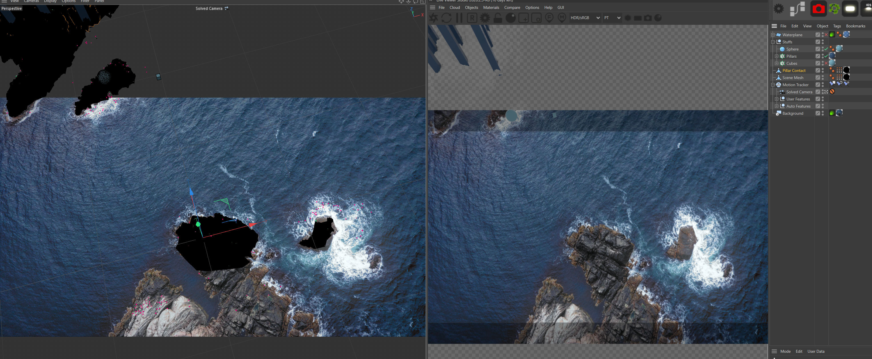

300 frame motion tracked drone shot with TIFF sequence (7GB) in background object with octaneobject tag and some simple meshes.
It renders, but Octane crashes when I scrub the timeline, and it always stay on the first frame.
I tried using the image sequence in an octane environment object which scrubs and renders as expected, but it projects wrongly.
3090 and 256GB ram, everything cached cached to memory / separate dedicated SSD cache drive.

monomagnus wrote:
I have this as well.
Why do you add object tag? It's not doing anything with background object.
Additionally, I'm trying to make some crashes with background object. Cannot do that, please send a sample scene. Small differences in parameters or setups can do changes
