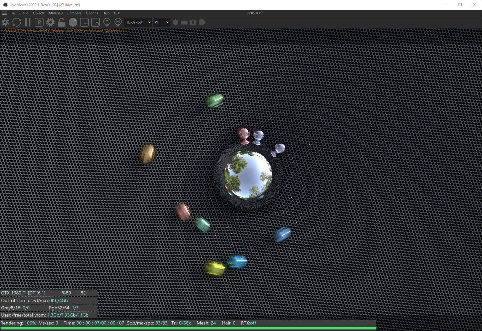

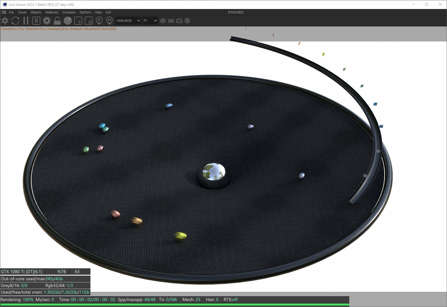

				MichaelJeffreyVance wrote:aoktar wrote:MichaelJeffreyVance wrote:Hi I have a test scene that uses Cinema 2024 new Rigid Body simulation system and I can't get motion blur to render in the Picture Viewer. Please see attached.
OctaneMotionBlurMV3.zip
It's not working because you need to cache the dynamics. We are using a temporal copy of scene for data and it requires to have data. Caching provides that. See the picture!
Ah I see. It has to be cached. Thanks. That seems a tinsy bit inconvenient, but having the ability is the important thing.
TBF, caching should always be the go to solution since it gives you the ability to rerender the exact same simullation and/or just a few frames of it.

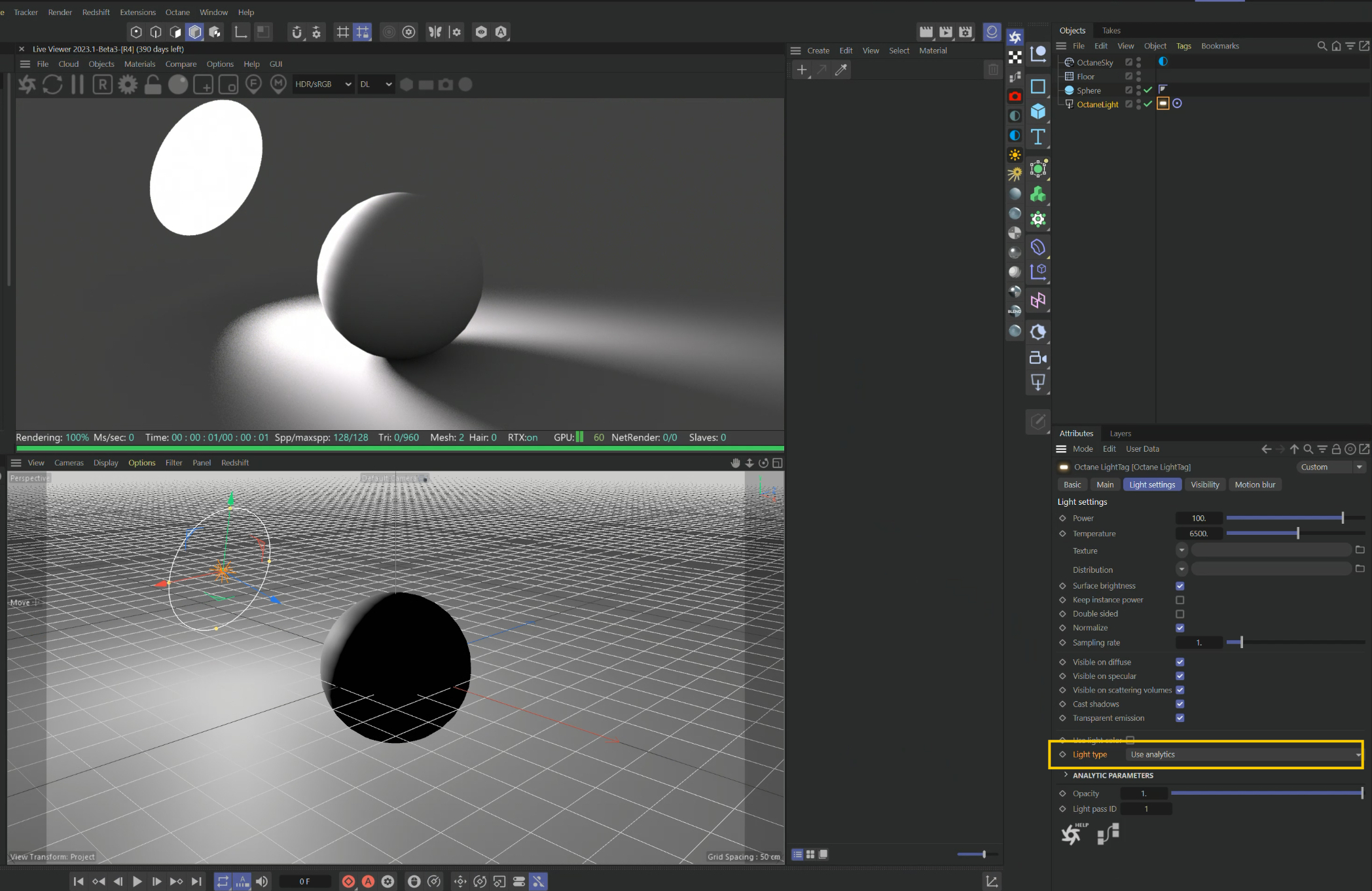

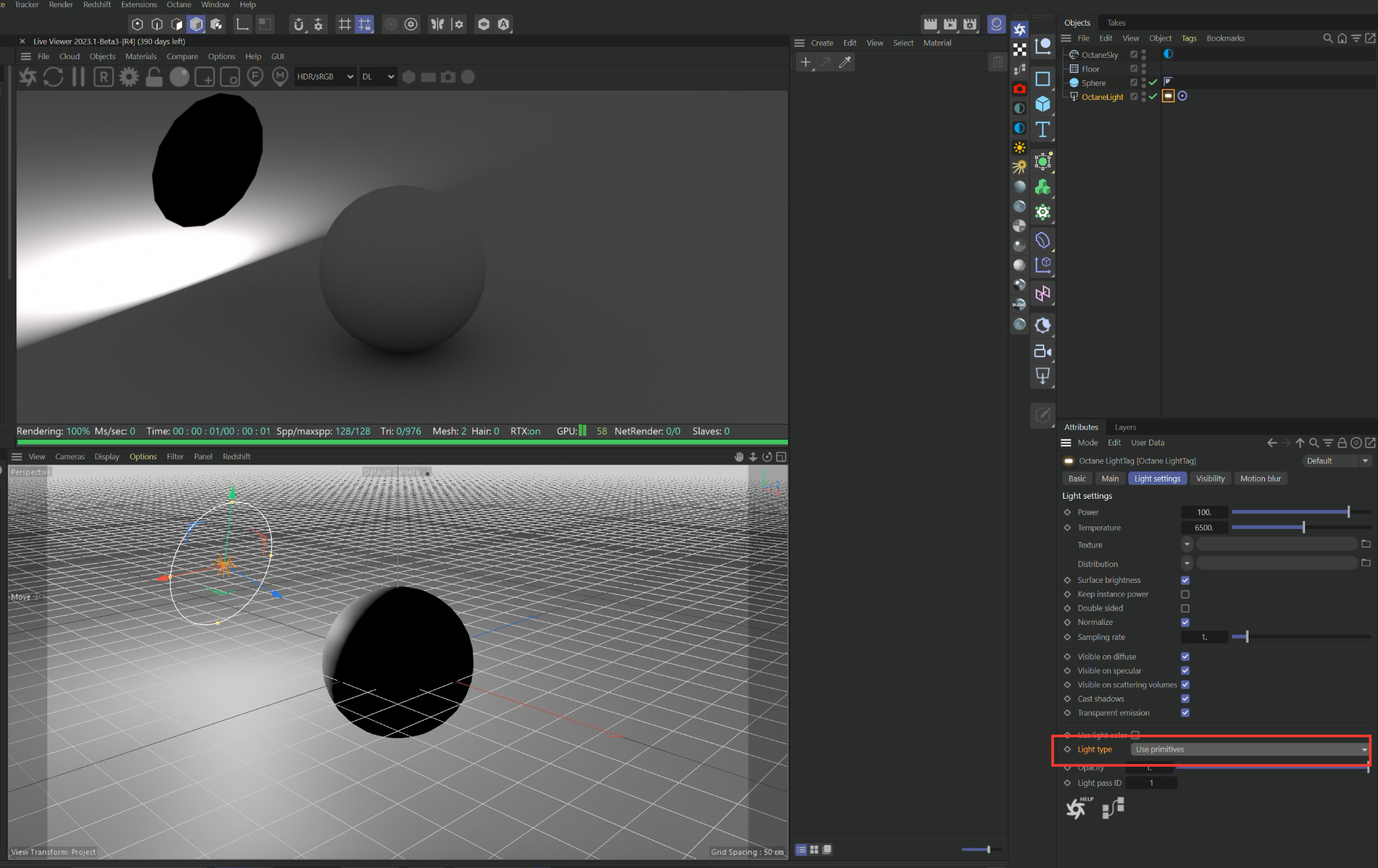

				Change the shape of the light to a disk and the direction of the light will be reversed
				Re: Cinema4D version 2023.1-Beta3-R4 27.09.2023
				Posted: Thu Sep 28, 2023 7:23 am
				by bepeg4d
confirmed, but please note that Disk primitive is supported only by new Analytic Light, so to fix it, you need to change the Light type, from "Use primitives" to "Analytic":
To recap:
- Default = only Rectangle
- Use primitives = Rectangle, Sphere
- Analytic = Rectangle, Sphere, Disk, Tube
ciao,
Beppe

				by aoktar
				bepeg4d wrote:Hi,
To recap:
ciao,
Beppe
Or switch to "default".
