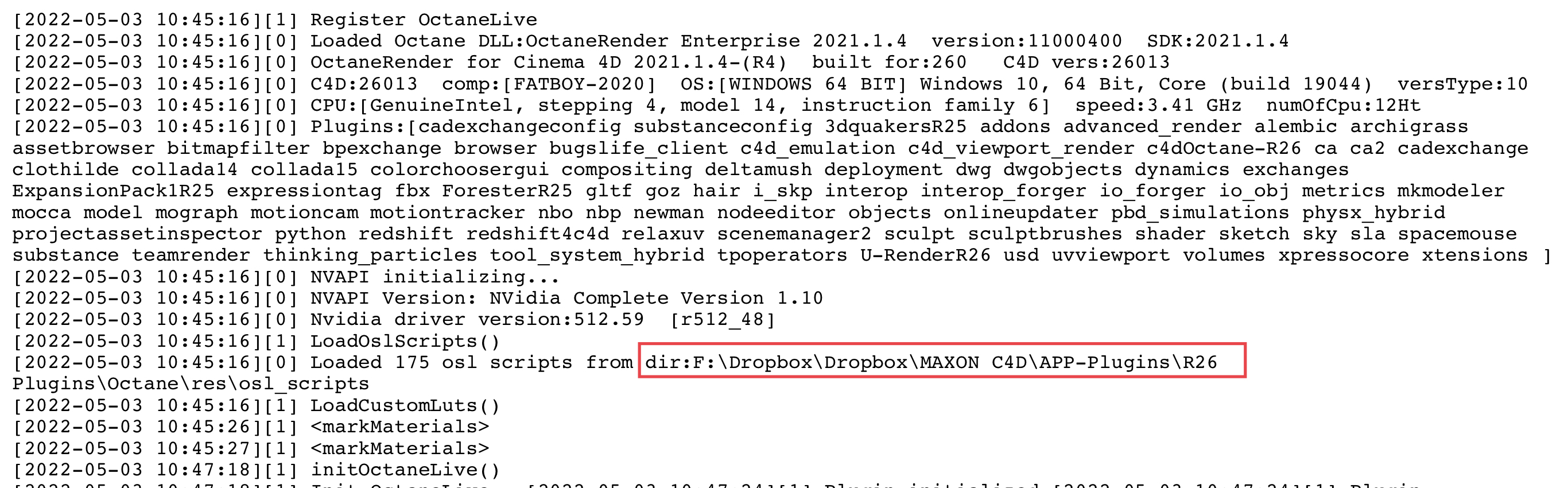

having some trouble with this and the previous version ...
My machine freezes after a couple of frames rendering and needs a complete restart. Even if working with LV it crashes after some time.
I tried different things to solve this without success:
- activated my 1080TI only for having more GRAM available
- changed NVidia settings of C4D like described here: https://www.youtube.com/watch?v=injfhCVLwBI
- confirmed that the TdrDelay settings are at a value of 60
I am using R26 with the latest version of plugin & standalone with NVidia Studio driver 512.59
BTW: the crashes are happening when using Redshift, too!
Any hints what I could further do?
Ron

Hi Ron,
the plugin is loaded from Dropbox, not good for stability:
Please install it correctly in C:\Program Files\Maxon\Cinema 4D R26\plugins\c4doctane (You have to create the plugins folder in lowercase!), and report back, thanks.

by Ron
bepeg4d wrote:Hi Ron,
ciao,
Beppe
Hi Bepe,
thanks for the hint. I did as you advised but without success. C4D is crashing even with simple scenes after a while working.
Maybe its a driver related issue?
Which driver is known to be stable with this plugin version?
Ciao
Ron

Ron wrote: Hi Bepe,
Ciao
Ron
Hi Ron,
please write to help at otoy dot com, asking for me, I can investigate more deeply.
ciao,
Beppe

by Ron
bepeg4d wrote:
Hi Ron,
ciao,
Beppe
OK - I will do but before I will do a clean install of old driver version 472.84 to see if the behavior is still the same.
