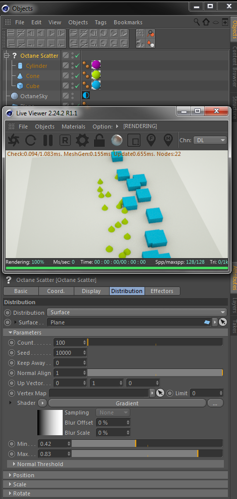

i wanted to achieve an uneven distribution. i thought for this is the shaderinput in distribution.
then i can control the distribution with the min and max slider. But this works only when i scatter only 1 single object. as soon as i scatter more than 1 objects this workflow dont work. because this sliders also influence which objects are used for scattering or not.
for example if i have 3 objects in scatterobject and the minslider is on 0.5, the first ibject is not used for scatter.
its more clear if you just use a gradient instead of noise
is this intended?
