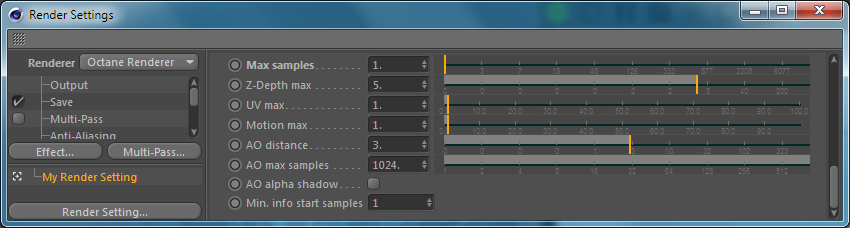

Thanks for making a great plug-in! I have some feedback/bug reports for version 2.14.0 (Win7 x64, GTX 460, driver v344.75). Some of it might come off as nitpicking but it's just me wanting to help you make the plug-in more polished. :) I'm not a developer or GUI expert myself so it's just my opinions but hopefully others will agree as well. I apologize in advance if some of it has already been discussed or is planned to be fixed.
Bugs:
1. The rendering of the custom value sliders is a bit buggy. For example, here is a part of the Octane render settings window:
Now try scrolling up and then back down again and it will look like this:
This happens in all places where these sliders are used (except maybe the Octane Settings window). It can be temporarily fixed by resizing the pane/window.
I'm curious, is it really necessary to use these custom sliders instead of the built-in C4D sliders? I know some use exponential values but it would look more consistent if you used the built-in ones.

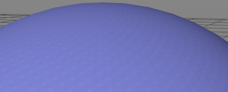

2. When adding an Octane material/shader to an object, the object looks strange in the viewport (small dots are shown on the object):

1-Custom sliders.....
Two reason to keep them. One is to allow updates when you are dragging, this is not possible on default sliders. Second to use logaritmic ranges. Many parameters are sensible to low values but need also big values. I know of course this visual artifacts. But i have no succes to fix until now.
Btw, i can put a option to use default sliders but i'm not sure that will reflect some advantages of our's.
2-dots on opengl....
We are using octane renderer to get previews. It's a pathtracer and generates some noises and colored dots. It's on my list to check
