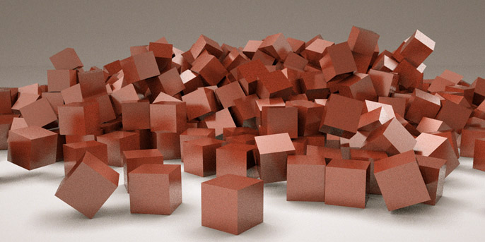

Hey Face,
I've been playing with the animation capabilities of your plugin recently (thanks again for that, it is so fun & fast now between XSI and Octane :) )
and I came across a strange behavior of the camera focal length (or FoV).
I always use the "render animation" button (either set to a range or a single frame as you stated in one of your first posts).
I have 3 passes, the beauty from Octane, a Depth and a Motion Pass from XSI.
The problem is that the focal length between Mental Ray and Octane do not match. The weird thing is that if I render just one frame (here the 40th) everything matches perfectly. But If the frames are rendered as a range they do not anymore as if there was some problem with the interpolation curve of the focal length... very strange.
I hope it will be clearer with a couple of images:
Wires
Wires
A frame rendered individually: perfect match
Same frame but rendered as a range (1-50)... focal length problem here
The final comp with depth and motion blur + grading
Has anyone else have had the same problem?
what do you think?
Re: Beta 2.2 RC1: SoftImage XSI plugin testing thread
Posted: Mon May 24, 2010 12:04 pm
by face
Can you try to change the interpolation from linear to spline?
face
Posted: Mon May 24, 2010 1:37 pm
by Amplitude
I switched between spline and linear interpolation as It was my first guess too but it still mismatches...
I did a little test: I rendered frame 37-43 , pausing Octane each time and taking a look at the fov parameter. For some reason the fov is correctly set on the first frame (37th here) but then it is not updated.
Posted: Mon May 24, 2010 1:48 pm
by face
Can you send me the file, without the geometry?
face
Posted: Mon May 24, 2010 4:38 pm
by face
Hm, when i load the scene, i have this.
And i can switch from linear to spline interpolation.
