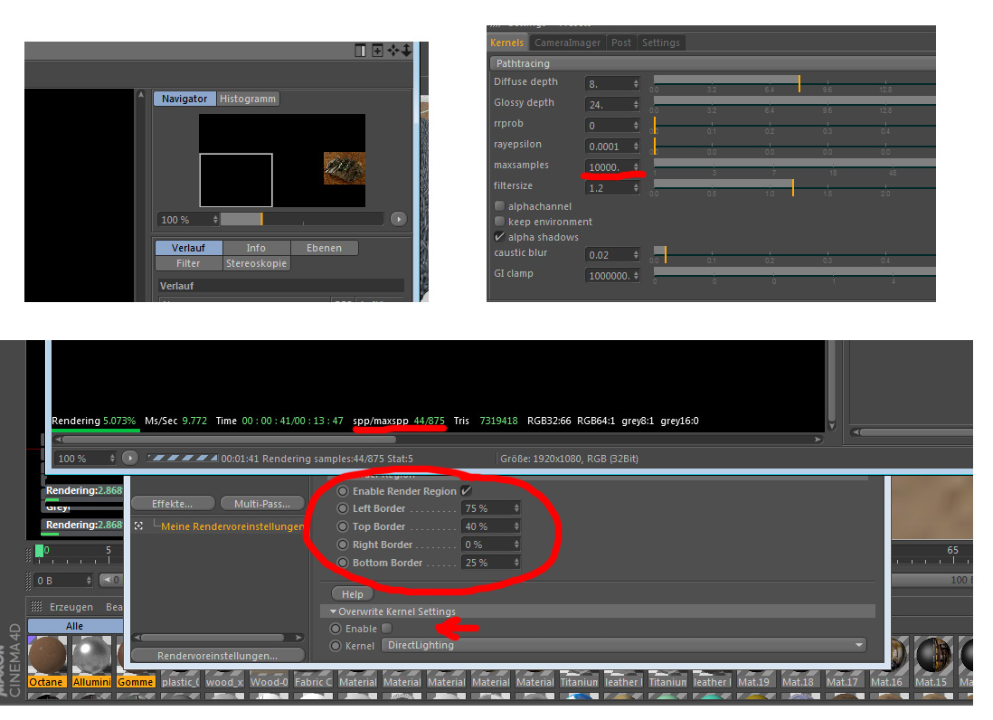

Hi there,
i am just rendering a region and my problem seems to be the following:
In the Render Region mode the Picturemanager shows me it will render 875 samples, the run befor it announces 800 samples. BUT i set 10000 samples in the settings and no "overwrite kernel settings"...
What is your opinion to this?
Lokking at the time it will render and the rendering it self, i am not sure if just the shown number is wrong and it is really rendering 10000 samples....
Thank you, Chriz
Working with fresh Octane- and plugin-versions in R16

hi chris,
this is expected behaviour. 10000 maxsamples is for whole area. But it makes a estimation for region to provide same noise ratio.
Formula is that regionmaxsamples = (region area)/(whole area)*maxsamples.
In your example, maxsamples=10000. Region is (1-0.75)*(1-0.65) = 0.0875. whole area=1.
0.0875*10000 = 875

Thank You for answering so fast! As i said before: It seemed to render better than i thought it would do with only 875 samples. :D
So, everything works fine! Have a nice day!
