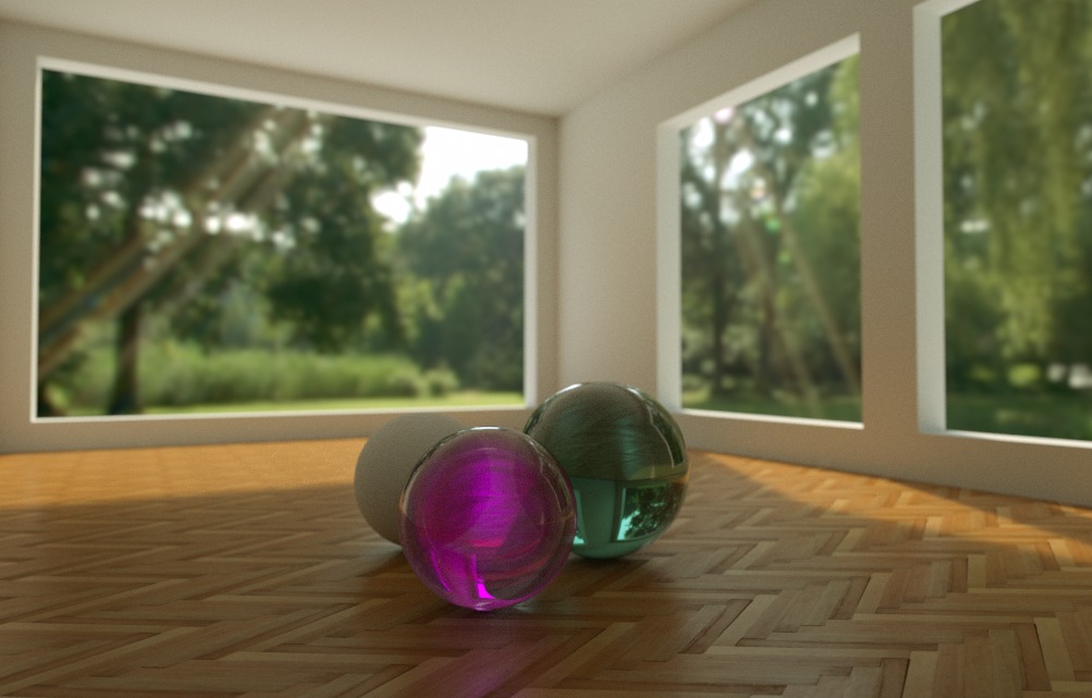

Re: Stabile version 1.01 (SDK 1.20.3) **** 17.01.14 ****
Posted: Wed Jan 22, 2014 7:58 pm
by cfrank78
This is Ahmets sample szene on my machine after 1 min rendertime. Hotpixel slider was set to 1. Never touched that slider. In my opinion it gives bad results! Tryed ahmets HDR and rainsaws. no difference! Win 7 x64. c4d r15 with Octane 1.10! Maybe a win 8 problem?
Chris!
Posted: Wed Jan 22, 2014 8:00 pm
by aoktar
Ron,
If you say that you got different result on this scene, really weird. It should be very similar as picture of CFrank. Can you put the output for this original scene?
This remind me a bad hdri images or wrong gamma settings. i think your setting is on for importance sampling, isn't?
Also save images was fixed a few million years ago. If you didn't reset render, it should work. Did you tried png8/16, exr outputs?
Posted: Wed Jan 22, 2014 8:19 pm
by cfrank78
Tryed it also in 1.01 1.20.3! I was curious! Same results like in 1.10, only texture and hdri looks of course difference, cause of new transforms!
Only 1.20.3 is a BIT faster! I get 13.3ms/sec in 1.20.3 hehe! In 1.10 it are 12.x
Seems to be a win 8.1 problem or your machine is not ok! Maybe another win 8.1 person can try!
Importance sampling on off can´t be this problem and also gamma and power cant be the problem ahmet, if he used your szene 1:1 and gets the same error and he said he did that!
Chris!

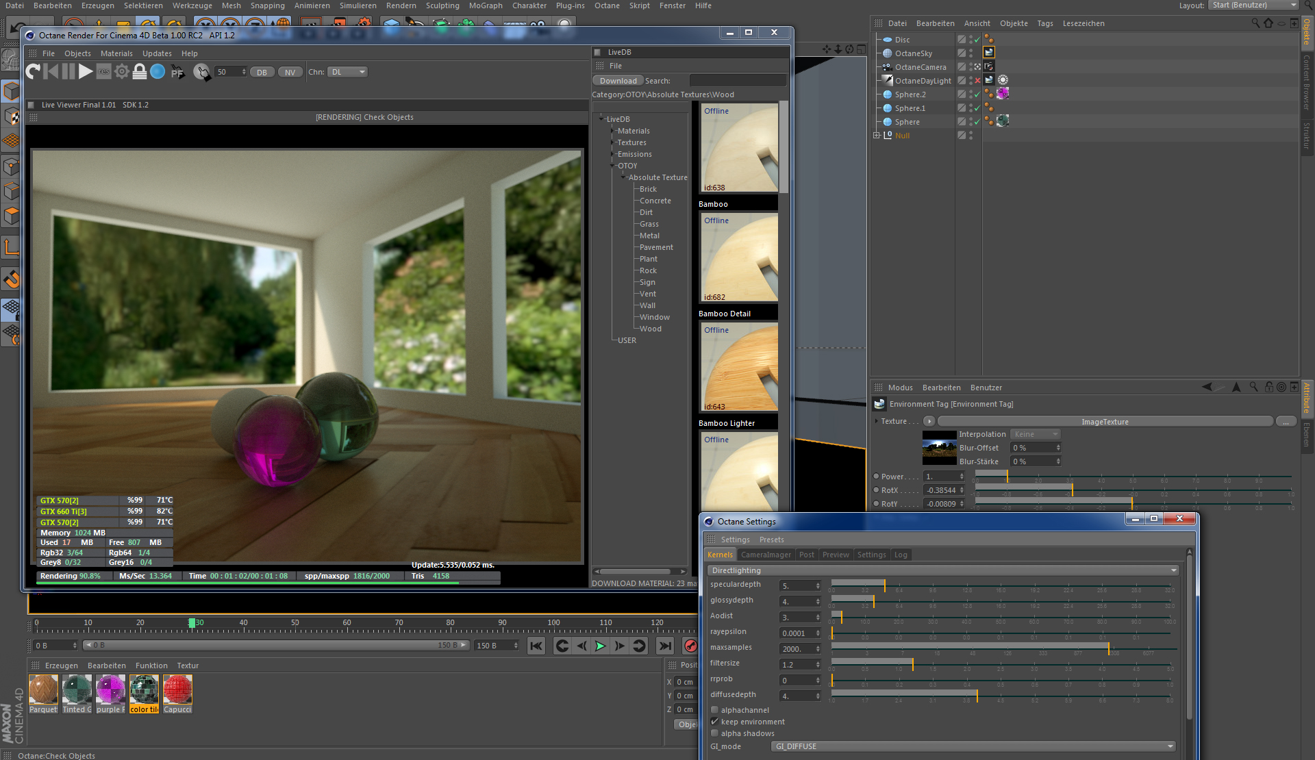

Posted: Wed Jan 22, 2014 8:26 pm
by cyartist
Here is a render on my machine. Win 7 64bit
