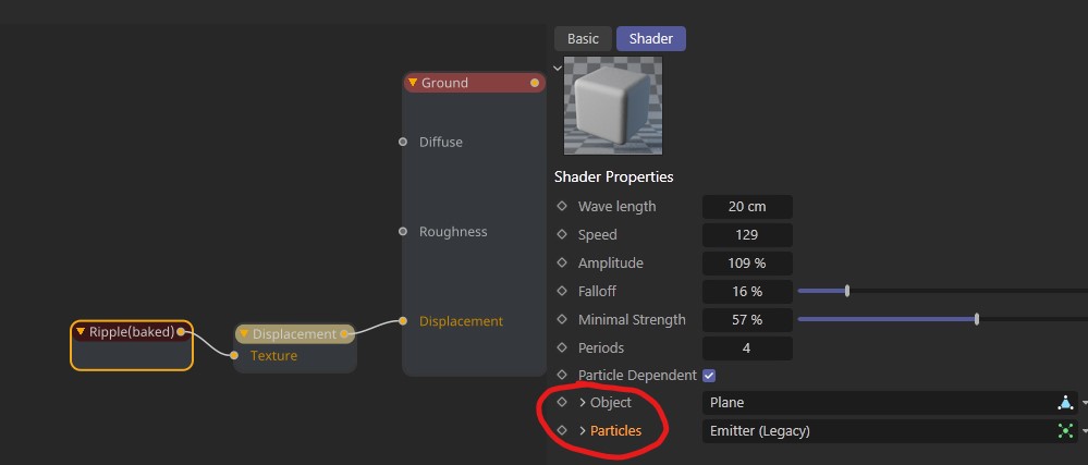

Two issues :
1. Ripple C4D shader ignore Object and Particles fields. Strange but most of the C4D shaders works fine :
2. There is no way to change brush color and brightness while painting textures if this texture is used in Octane material. Brush is completely locked, even Eraser doesn't work :
