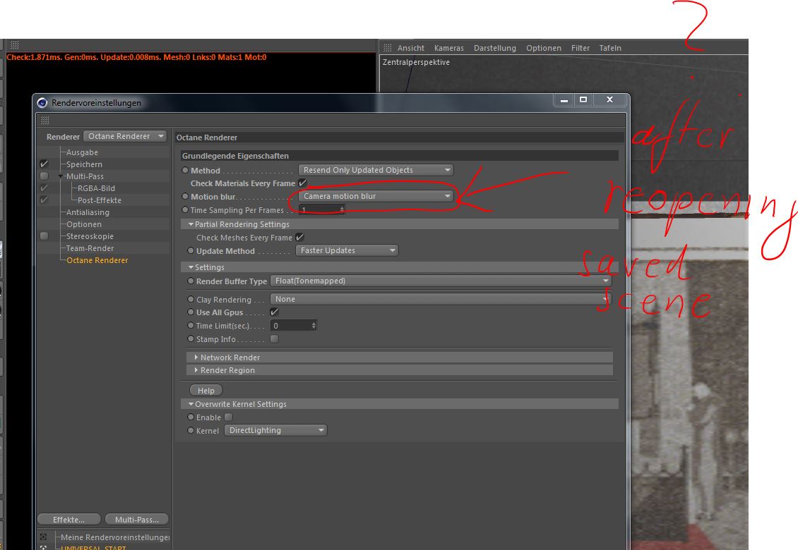

The other thing is, that octane 2.03 does not remember rendersettings in saved file.
I set "Full Motion Blur" and save. After reopening saved scene Motion Blur is set
to "Camera Motion Blur".
Again, what else should I tell you. No bugreport is created.

Btw. what do You think about render settings always jumping back
to "Camera Motion Blur"?
thanks
Mike
thanks
Mike
ok, i can't see a problem with imagesequences. Hard to tell something about freeze. Keep LV and octane windows are closed while rendering.
Also camera motion blur changing, it's not a problem. Even, i haven't see that before. Please try with a older version.
