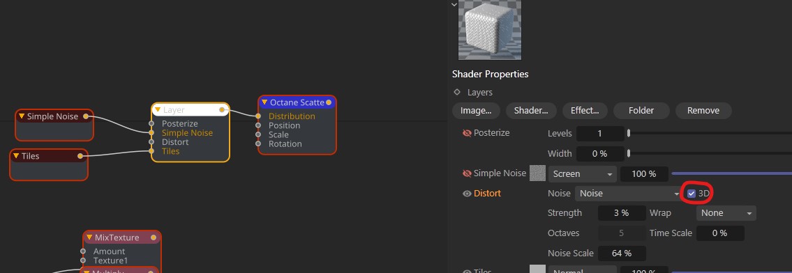

				by SSmolak
				Distort 3D mode doesn't work in baked Layer Shader connected to Octane Scatter distribution :
