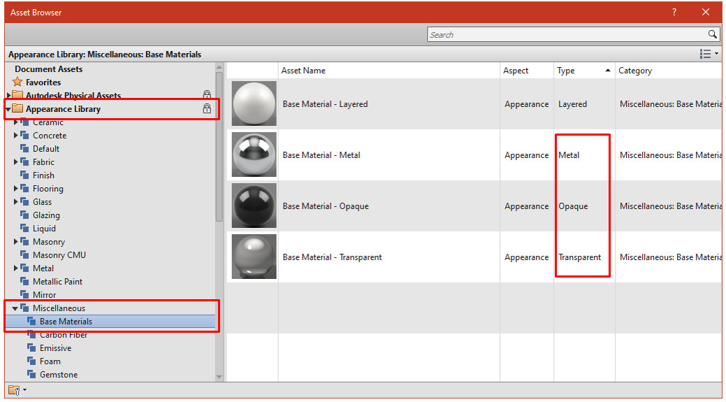

The Revit material system can be quite confusing, materials are made up of assets, imo we can ignore all except "appearance" wich basically defines the shader.
Appearances marked with a yellow exclamation mark are legacy materials, at least in 2019 new materials are still created with a legacy appearance.
You can find new shaders in the appearance library.

I have had a further look at this. Firstly, the Revit API has no information on any of this. Even googling gives no help. I can tell you that "Aluminium - Bead Blasted" has a material schema type of "PrismMetalSchema" - and if you google that schema name, or search for it in the Revit 2020 API documentation, or search for the schema definition in the C# API, there is no trace of it. So there is a lot of reverse engineering required here. The traditional Revit schemas (GenericSchema, HardwoodSchema, ConcreteSchema, etc) at least have a definition in the API. So it is unclear if there are other schema's that are undocumented that I have not yet found.
I was able to reverse engineer through experimentation that the PrismMetalSchema and PrismOpaqueSchema schemas are the usual types for a material with a Parameters section in their appearance.
It would be possible to convert PrismMetalSchema and PrismOpaqueSchema materials to Octane Universal materials and leave the other schema materials converting to Octane Diffuse, Glossy and Specular materials as per the current rules.
