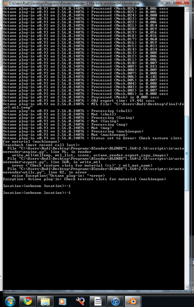

radiant wrote:yoyoz can u please evaluate this problem
HI radiant, I have this problem before, I just thought this may help.I do have some material with texture missing or with names that has underscore (_), in your case you can check the texture slot of 'machine gun'.the texture might be missing or relocated or renamed.
of course we need it to be checked by yoyoz.
thankz!!
chow!!
Re: Non-offical Blender 2.56 plugin
Posted: Sun Feb 20, 2011 3:54 pm
by yoyoz
@ radiant: I confirm this is symptomatic of a missing texture (texture slot defined but empty or not defined to an image/sequence). BTW, underscores should not give problems. The previous exporters ignored this error but it meant others errors would have been masked too.
@ r0ug3r: I'll need to see the mtl you get from the exporter. May be the logics of 2.43 have changed but I've not tested this area specifically. In addition I can hardly test myself now as the exporter doesn't work well with the latest builds of blender which I use for developping the 'next-gen' exporter... Manually pulling specularity down to 0 may help forcing material to diffuse if I did something wrong. check IOR = 1 too...
