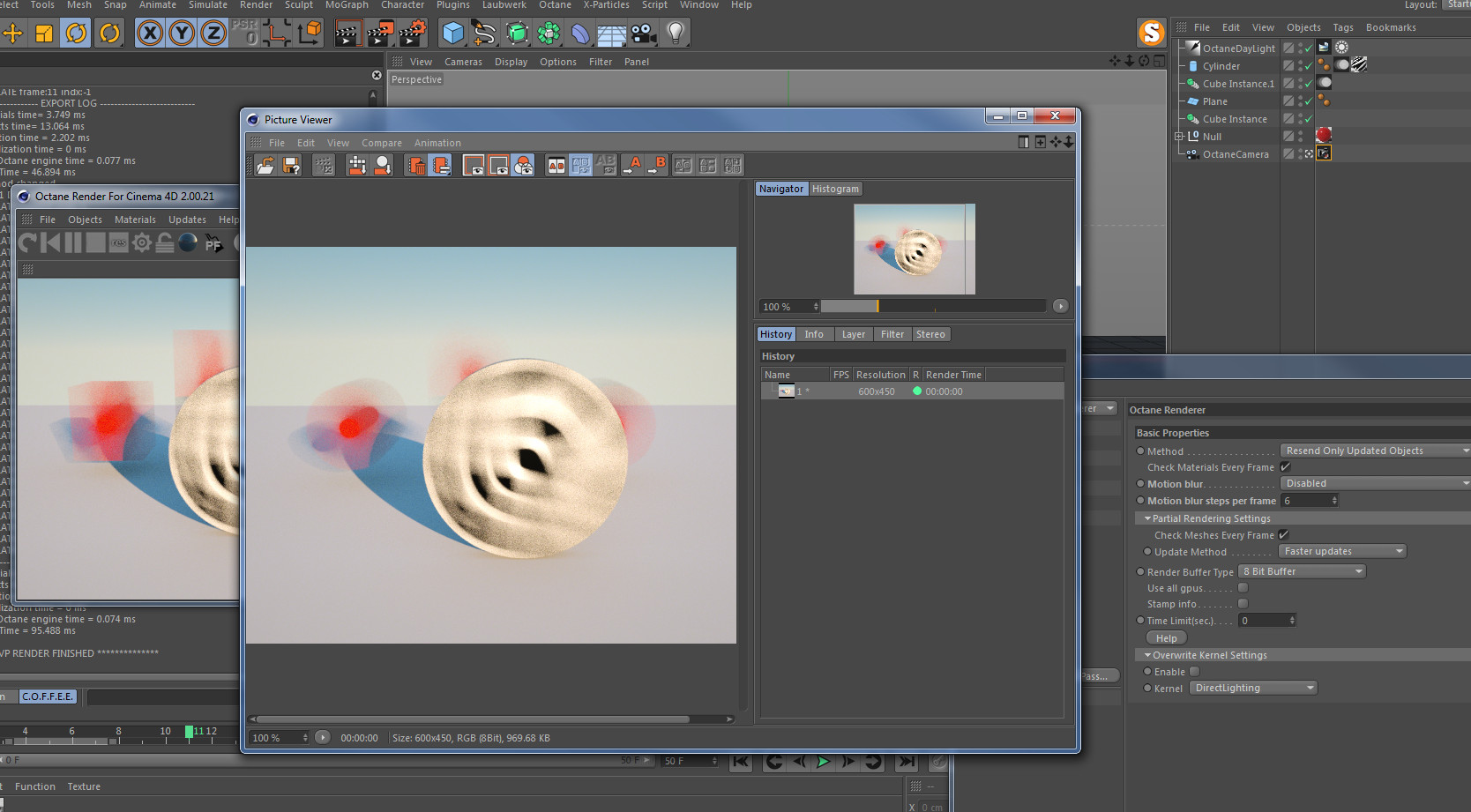

Hi all,
I'm working on some bugs and optimisation for motion blur. Especially for render instances. Also added a new parameter to render settings. Time sampling per frames. This is for exporting sub calculations between two frames. To overcome some weird effects on big rotations. Default is 1.
A test version for R15 windows is here. Could someone test it please?
http://render.otoy.com/customerdownload ... 23-R15.zip
fast_rotation_mblur.zip
Sample scene for fast rotating objects
(124.72 KiB) Downloaded 269 times
Please check the results. This show how effect the new parameter
Incorrect results due big rotation and low time sampling
Correct results on rendering with enough big time sampling

Seems to fix the issue with 8 'sampleing per frames' on my system.
