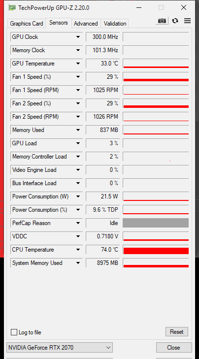

Can you please check my answers then? I am following all your instructions:
I downloaded 431.70, it didn't work
I downloaded the latest 431.86 (both for 3D artists) it didn't work
I posted the GPU temperature when rendering:
The computer is rendering normally when using Physical but using the CPU without using GPU
Octane is always crashing when using the GPU
I posted the OctaneLog text that Beppe requested, I believe it should help you figure out what the problem is
what more answers do you want from me? It's still not working
