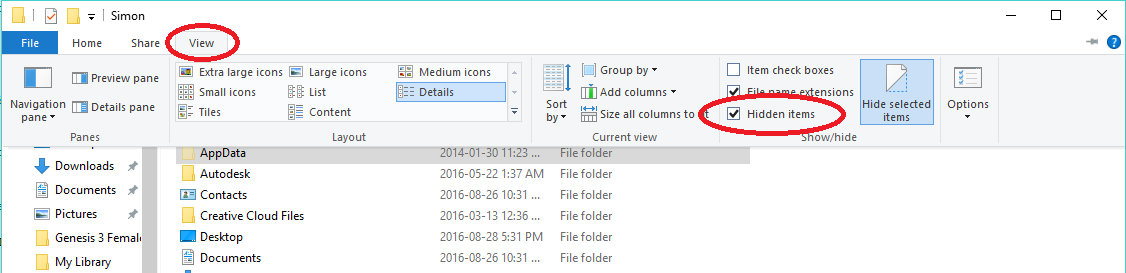

It looks like you might have a corrupt settings file. Please try to locate and delete all the plugin user.config files located in your AppData directory:
Mine were located here:
C:\Users\Simon\AppData\Local\DAZ_3D,_Inc
Within that directory you should find sub directories that look something like 'DefaultDomain_Path_g2zzw5wbksxx0yrpq5z0fnxllbxkqvav'. Just delete any that you find and then restart Carrara.
Note that the AppData directory is hidden by default so you will need to go into Explorer settings to make it visible:
Open explorer. Select the View tab. Enable 'Hidden Items'.

Re: OctaneRender for Carrara 3.03.04.22[Stable]
Posted: Fri Sep 30, 2016 1:43 pm
by Nod64
Hi there,
That did the trick.
Noel
