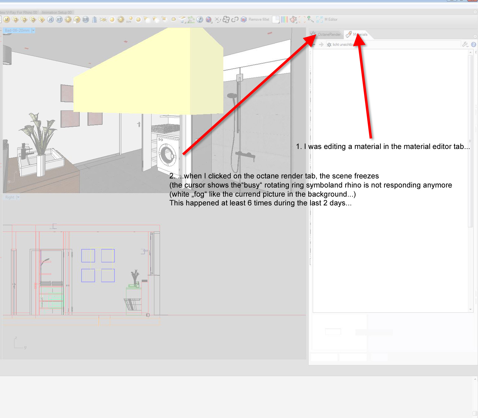

				Hi Paul,
latest release runs great expect from one thing...
As shown in the attached picture, i recently run into rhino freezes when changing the tab from "material editor" to "octane"
Sadly it is not repeatable but happens quite often. I will try to analyse it further to see it is scene specific or not...
best regards
Andreas

				Thanks Andreas.  If you can provide a concise workflow which allows me to reproduce this, I can check it out.   In particular, is it a certain type of material edit function which causes the problem?  Does separating those 2 tabs into separate panels fix the problem?  Which SR of Rhino5 are you using?

				Hi Paul,
first, i also get the freezing issue sometimes when changing from material editor to octane window. it appears only when the material editor is included in the toolbox on the right as shown in the screenshot. I use octane at work so later on i can tell you which build is in use. i use direct lighting kernel if that helps.
I sent some time trying to get this error to occur, but cannot.  I have the Octane Settings and Materials tabs in the same panel, but no amount of swapping between tabs and editing materials makes Rhino lock up for me.  I am on Rhino SR8.
