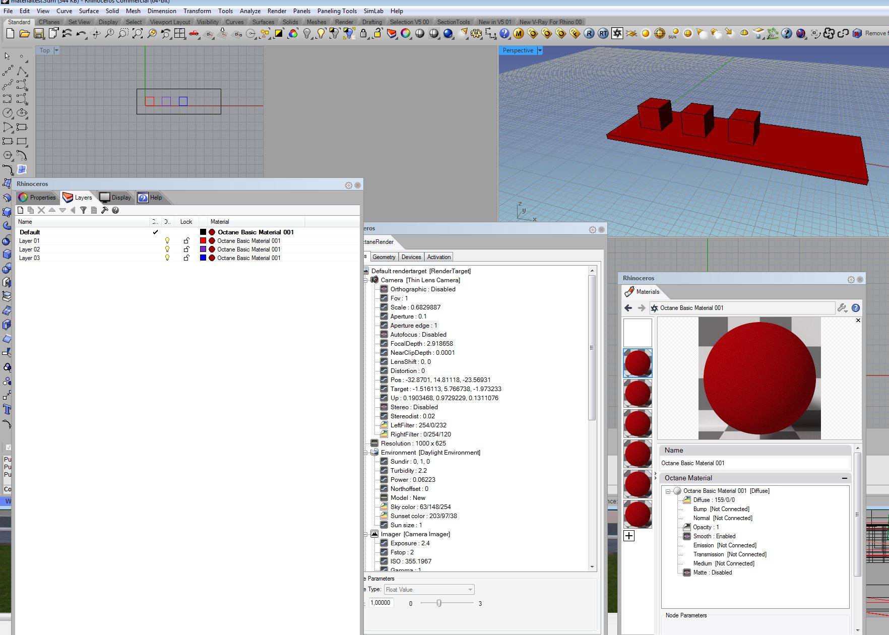

I took another look at the duplicate material issue and it seems that during the automatic, right click triggered material conversion process, octane creates a separate material for each layer, regardless that these share just one single material ( please see attached pics...)
This behaviour is the same for both vray or native rhino materials.
