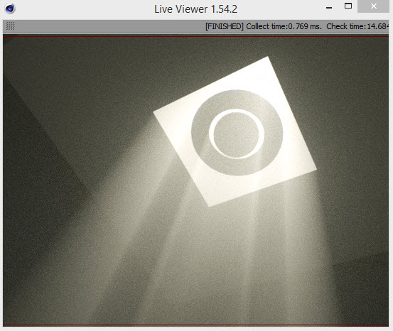

Scattering Medium... Malfunction.
Make a simple volume-lighting scene.
Test : Ver 1.54.2 : Good...
Test : Ver 2.00.22 : Malfunction...(Sometime Can Visible)

eyeonestudio wrote:Scattering Medium... Malfunction.
Your Fake shadow seems to not be activated. Maybe is it an explanation ?

by eyeonestudio
You Don't Need Fake Shadow Option in this scene (Not Sphere, Not Torus. Focus Volume light Effects) :)
