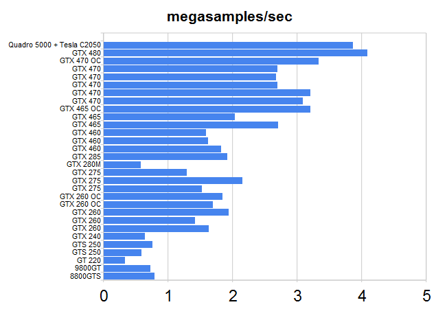

i've compiled everyone's results into a spreadsheet. here are graphs! we love graphs!
Raw performance numbers:
And Newegg cost per megasamples/sec. This is the number of US$ you pay per megasample :)
Enjoy!

Hmmm, I saw the speadsheet, nice idea by the way!!!
Something is wrong with the quadro 5000 + tesla c2050, their result should be twice the 480 one!
Driver problem??? Need to check...

gtx 460 is fast as 260????
I wrong?
