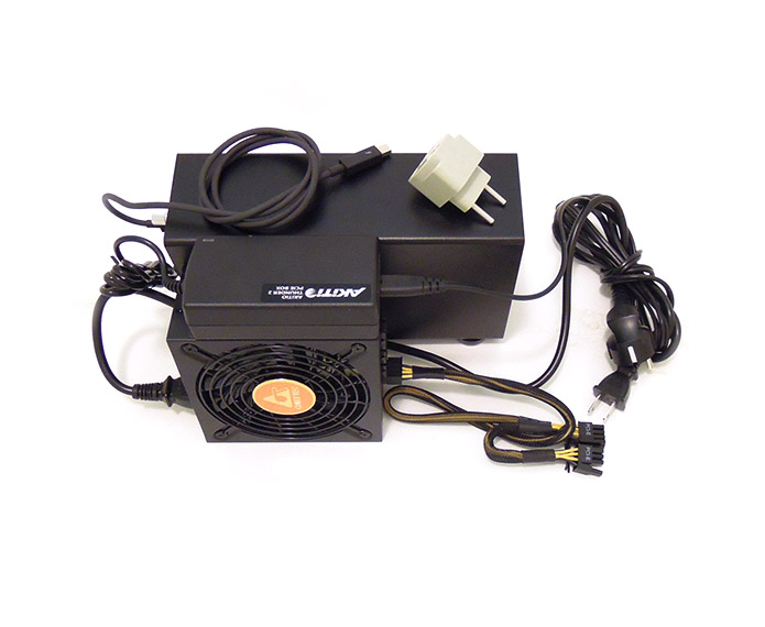

by glimpse
prodviz wrote: What would be the best route to go down, for testing purposes?
akitio might be the most simple solution for now =)
Using SFXL solution might be good Idea:
Having PCIe ribbon cable to displace GPU migh help as well to avoid case modification in the beginning
Here is how solution looks with back of the Akitio modiffied to allow accepting long cards =) works even with MacBookAir..
Hope that helps =)

by prodviz
I’ve contacted Akitio and they said that unfortunately, they cannot provide support for their PCIe to support GPU cards. They were very helpful, and suggested searching the TechInferno AKiTiO forums, but again, any modifications done to the box would void any warranty.
Re: Mac + eGPU
Posted: Fri Apr 29, 2016 1:17 pm
by natemac00
I've been using the Bizon Box 2 for about 3 months now with no issue.
If convenience out ways cost like it does for me I would recommend us .
https://bizon-tech.com/us/bizonbox2-egpu.html
Re: Mac + eGPU
Posted: Fri Apr 29, 2016 1:27 pm
by glimpse
bizon & akitio is basically the same unit..as far as I know. Reason why Akitio do not provide any guidance is because that requires human resources using time explain so on.. - there's tons of information in the google if You know how to search & that should not take too much time to figure thigns out =), but yeah.. if You seem rather to buy solution as is.. paying a bit more to get bizon might make sense..

glimpse wrote:bizon & akitio is basically the same unit..as far as I know.
Not basically, it is. They even left the akitio logo and serial number on the bottom of the device.
