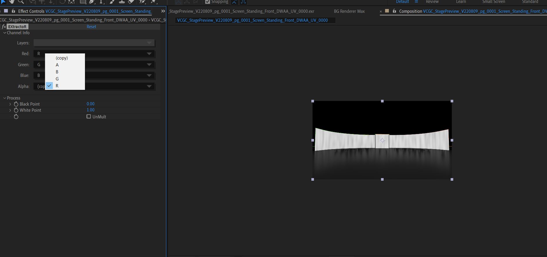

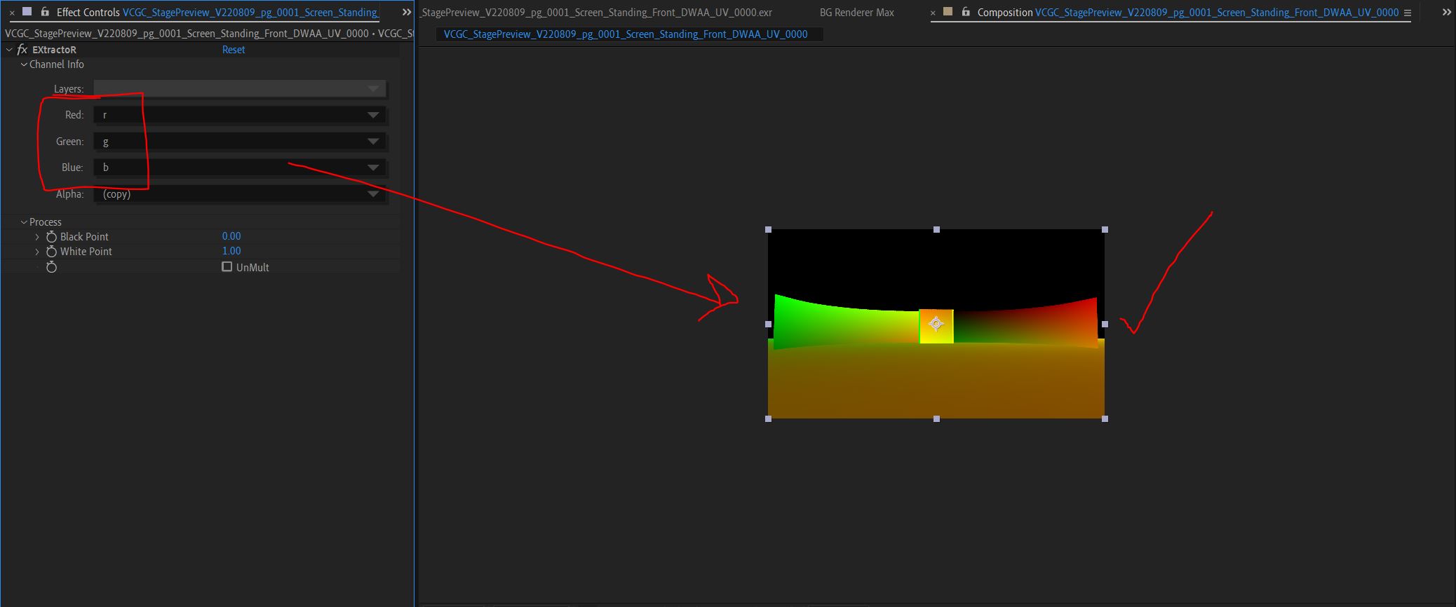

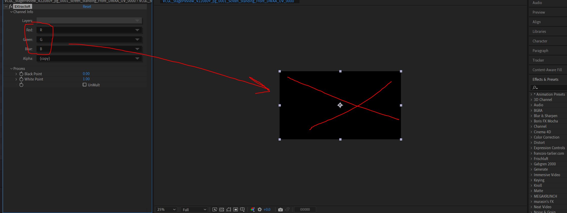

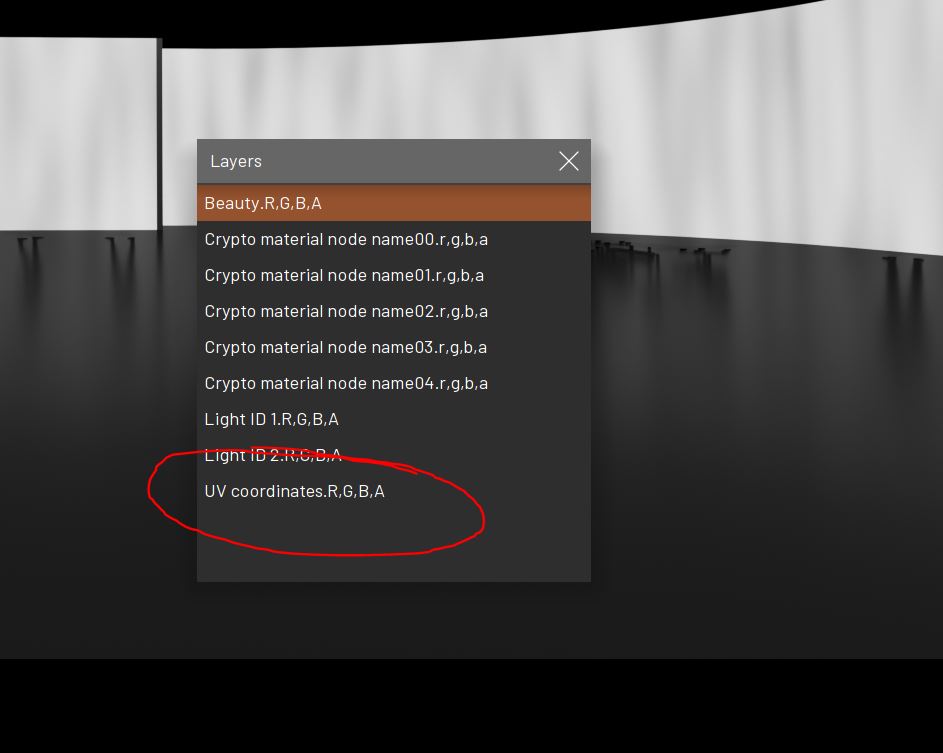

aoktar wrote: The thing is working with any older version? I don't have AE to check but it looks like working with the other softwares
So I have explored this a bit more, and I think it comes down to AE being case sensitive to the channel naming.
When I bring in the UV pass it is black...and when I add an extractor plugin it defaults to Capital letters for the channels.
But when I manually assign a channel, the channels are labeled lowercase...but the manual assignment works.
When I check another pass that was rendered the channels are labelled correctly with Capital letters
Checking in DJV I can see that the UV pass is indeed written with lower case letters for the channel names
But when viewing a RLE encoded exr the UV layer has capital letters for the channel names
Obviously it would be great if after effects was not case sensitive here...it seems like most apps are not case sensitive.
But also it would be wonderful if octane was using consistent channel naming conventions. Like ALL caps for channel names rather than switching between caps and lower case.
