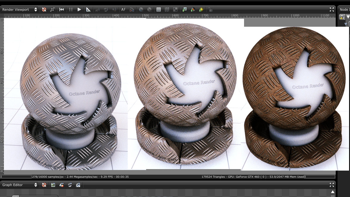

I've re-done the theradplate material, now it's more useful & looks better :)
* materials/non-organic/metal/ Threadplate Rusty v1 b243
The Rust Intensity slide controls how new & clean (0.0) or old & rusty (1.0) it looks.
