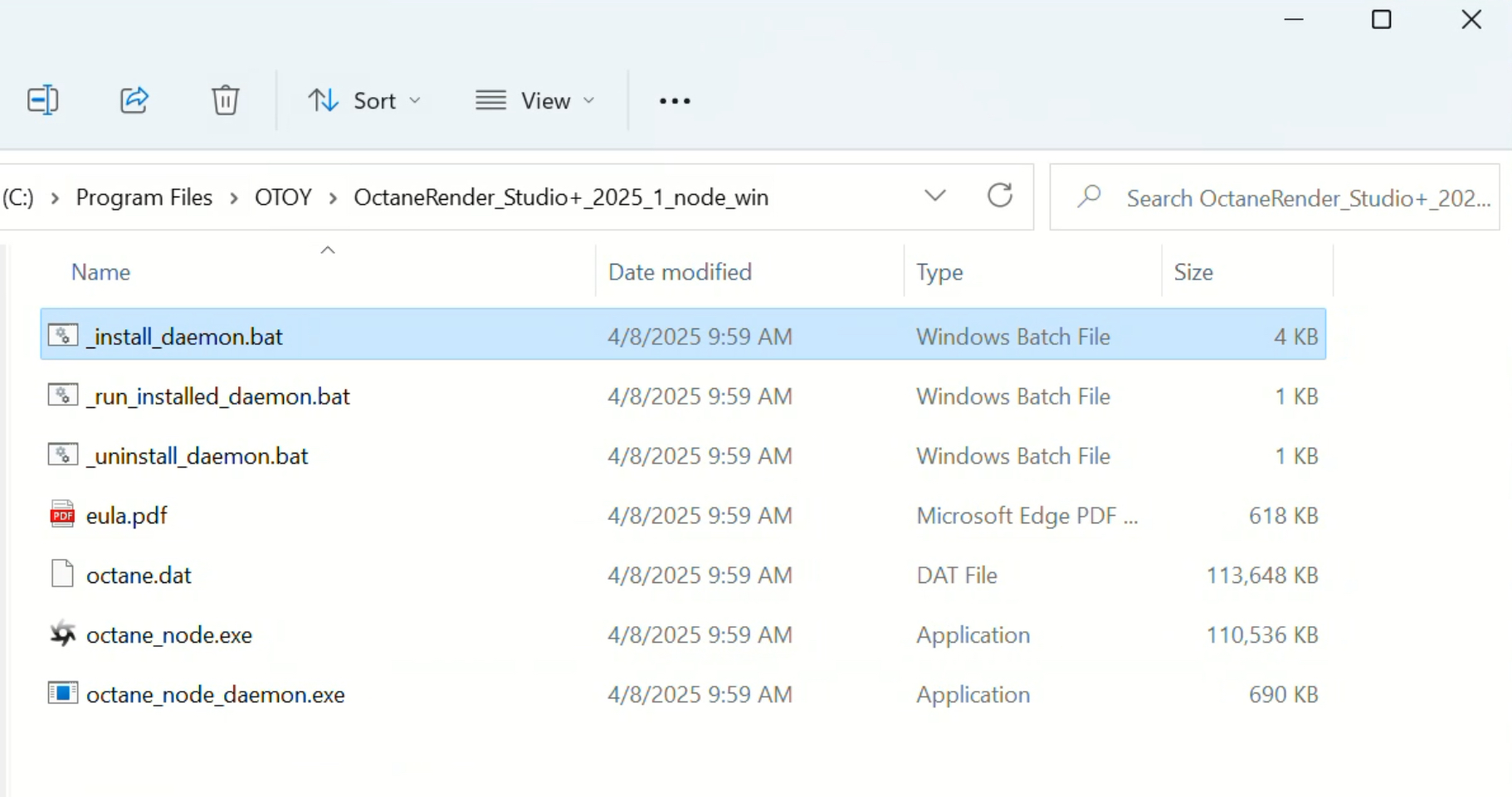

So I'm starting a new work and installed the daemon node thing,
but as soon as I launch it I get the message "Daemon startup script does not exist. Please install the daemon first."
Which is what I just did...

Hi Jukyan,
just to be sure, did you run the "_install_daemon.bat" script first?

by Jukyan
Thank you Beppe & everyone, it works like a charm :)
