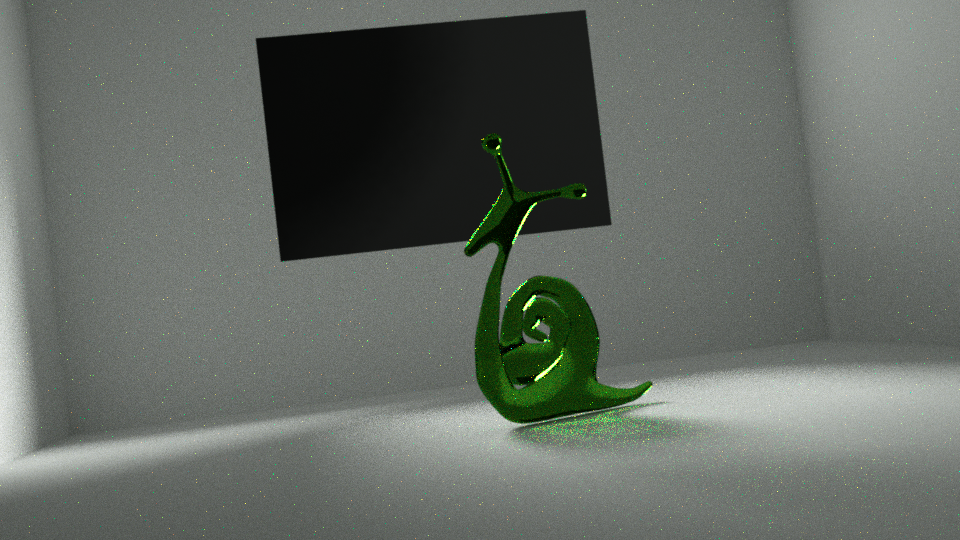

				one more quick question before I continue with experiment:
why is it that specular material not casting a colored shadow? even after I change "specular" and "tranmission", I am still only getting a black shadow cast from daylight.
				Re: Caustic etc
				Posted: Sat Sep 03, 2011 12:42 pm
				by enzyme
				here is a test render. no caustic on this one, yet. the window hole is a Portal.

				I hope you use pathtracing and not direct lightning...

				Ok, there are some caustics when using HDRI with "pathtracing" or "pmc" mode.
				Re: Caustic etc
				Posted: Sat Sep 03, 2011 1:26 pm
				by enzyme
				yeah, the shadow is still black, even when I use pathtracing.

				I read another post and matej also answered the same question:
"refractive caustics currently work only with IBL & emitters, not sunlight, I forgot about that"
- J

				That explains also why the shadow of glass objects with daylight illumination mode is black and not transparent. Caustics & transparent shadow is the same phenomenon.
At some point this problem will have to be solved. I wouldn't mind some "non physical" tools, like a "sunlamp" or something (to go together with a HDRI), because in the end people care more to achieve a certain look, not how physically correct that look is.
