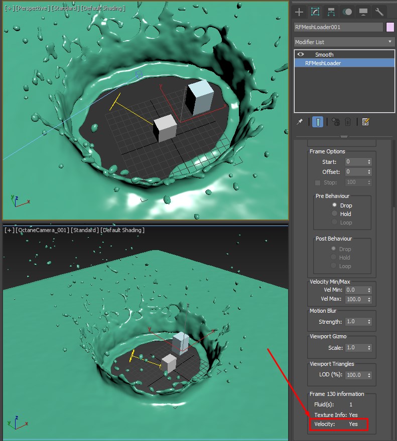

Hi Paride,
Velocity channel is present, check attachment. Confirmed here and I also tried to import these same scene into Cinema and there is velocity present

Hi maneality,
thanks for your info.
The issue should be fixed in the next 3dsmax plugin release.
