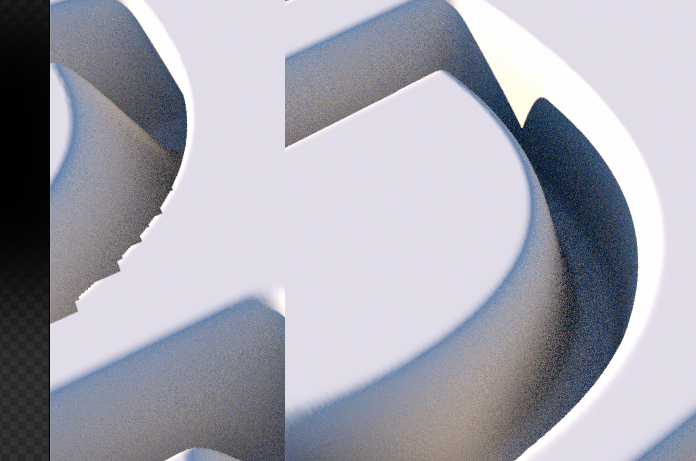

The Displacement in Octane can be a bit "weird".
Some things that might be worth to note:
  • A Texture that has sharp transitions between max & min (etc) are more likely to result in weird artifacts. Textures with gradients/soft transitions (between extreme values) tends to work better.
  • Greater height values are more likely to create artifacts
  • Using the Displacement node can create "split edges"/holes in the mesh.
  • Artifacts can appear at different places depending on the angle etc of the camera (see below)
  • Increasing the Ray Epsilon" value (in the Kernel Settings) might decrease (some of) the artifacts.
This shows the same part of the object, the only difference is that I moved the view so the D was more in the center in the right image:

ChrisH wrote:The Displacement in Octane can be a bit "weird".
Thank you for the crash course in textures as they relate to Displacement!
I played around with the Kernel settings, and I also tried less contrasting images with smoother transitions between black and white, but I think the "split edges" you mention are probably the reason for these issues. So for now, I think the Gaussian filter is the best method I've seen for my purposes.
Regarding camera placement: Yes, I deliberately stress-tested the Displacement method and looked for the absolutely worst camera angles. :) I could probably have gotten away with it in the right light -- I just try to get it as right as possible from the start, so there won't be too many unpleasant surprises along the way...
