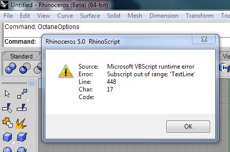

by timbarnes
Hi:
I get an error when I try to run OctaneOptions (see screenshot).
Thanks for your help,
tim
Re: Rhino Plug-in 1.022r01.01
Posted: Wed Oct 13, 2010 2:24 pm
by SamPage
timbarnes wrote:I get an error when I try to run OctaneOptions (see screenshot).
Could you send me the exportOptions.ini file? It can be found at:
Vista / Win7:
[WindowsDrive]:\Users\[User]\AppData\Roaming\OctaneExport\exportOptions.ini
XP:
[WindowsDrive]:\Documents and Settings\[User]\Application Data\OctaneExport\exportOptions.ini
As an immediate fix, try renaming exportOptions.ini to something like exportOptions.old, this should force it to recook the export options. When I get your exportOptions.ini file I can take a look and see why it failed.
Posted: Wed Oct 13, 2010 10:38 pm
by timbarnes
The file is present but empty. I deleted it to see if the plugin would create a new one, but after running OctaneOptions again, no ini file was created. I got the same script error, however.
