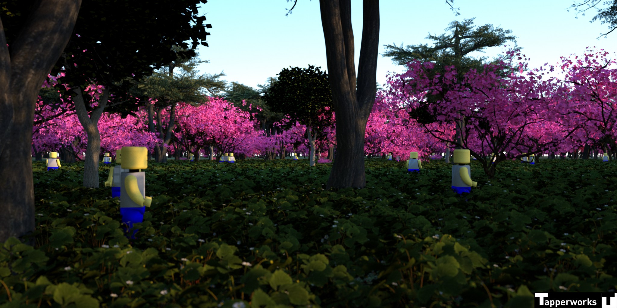

Legomen looking for some fruits to pick in strawberry field
