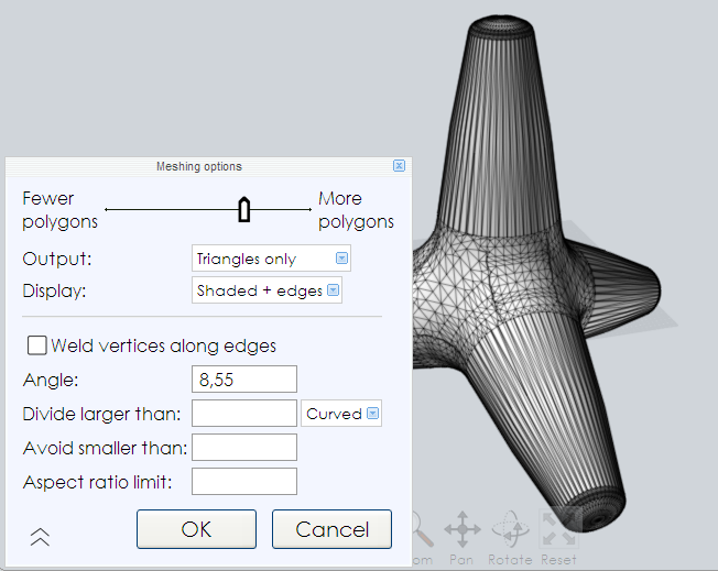

Re: From SolidWorks to Octane
Posted: Fri Jun 04, 2010 12:39 pm
by Kaspar
Here it is:
Posted: Fri Jun 04, 2010 3:21 pm
by Marc Tellier
Hi Kaspar, for this model you could try 'divide larger than' in the export meshing options.
This way it would ease off those long narrow triangles.
Marc
