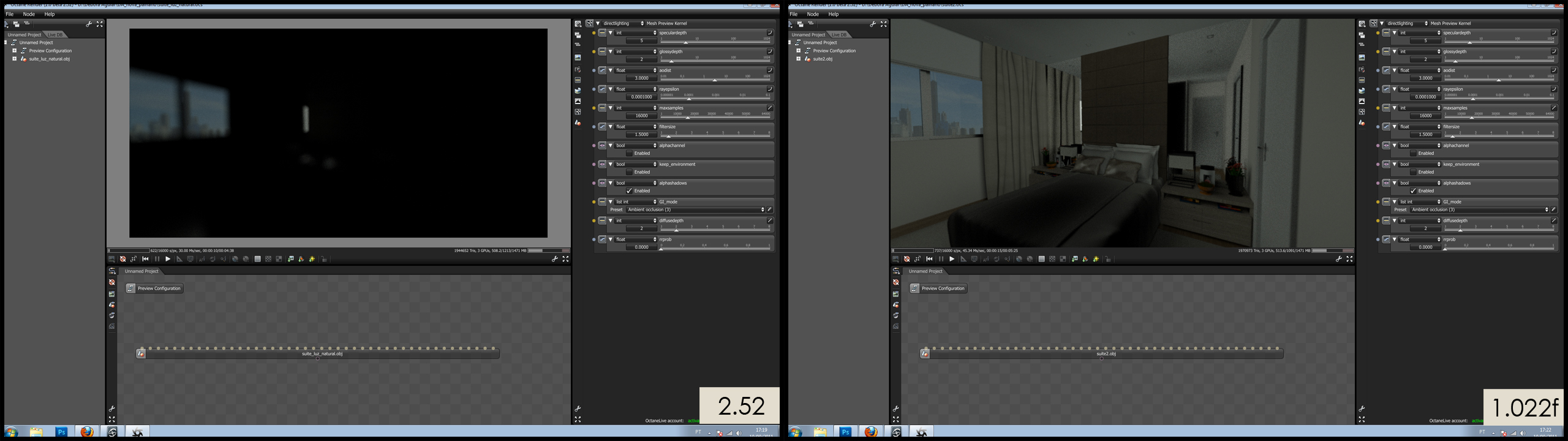

Hy Face!
Could you please help me to understand why, exporters plugins 1.022f and 2.52b have different renders results in octane?
For example, when I export a scene with 1.022f, directlighting works in one way.
Then When I export the same scene with 2.52b, directlighting works in other way.
I´m using Octane 2.52
By the way, with this new version of Octane and Plugin Exporter I cannot render daylight scenes..
Only with Illumination on PMC.
If you don´t understand what I´m saiyng I can post some pictures here.
Thnks

Here it is 2 images.
The project and paths are the same. The image shows how the projects open in Octane for me.
As I say, The render results are different.
As like directlighting... PT and PMC gave me different results too.

DI2011 wrote:Hi,
Ah ok, i think thats because i have changed the unit size in default decimeters.
The scene has also an other size so that the emitters need an other setting...
