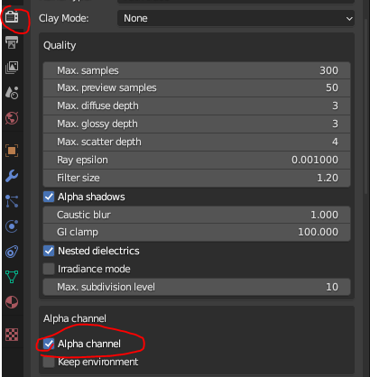

Hi all,
My scene has a grassy foreground and some hills in the background. I'm rendering the grass separately with the alpha turned on. When I overlay the grassy layer on top of the mountains, I'm getting this weird white outline. Is there a setting I'm not aware of right now?
Render with the white outline
Render
Here are the settings I'm using:
Settings
Thanks in advance for any response!

That seems to me an Premultiplied Alpha problem. I use an Alpha Convert node in the Compositor to fix that.

Postby timAugustine » Mon Feb 26, 2024 8:59 am
timAugustine Mon Feb 26, 2024 8:59 am
Thank you! I will try this tomorrow

I must have done something wrong. It works for me now. And it also fixed the issue for me. Thanks again!
