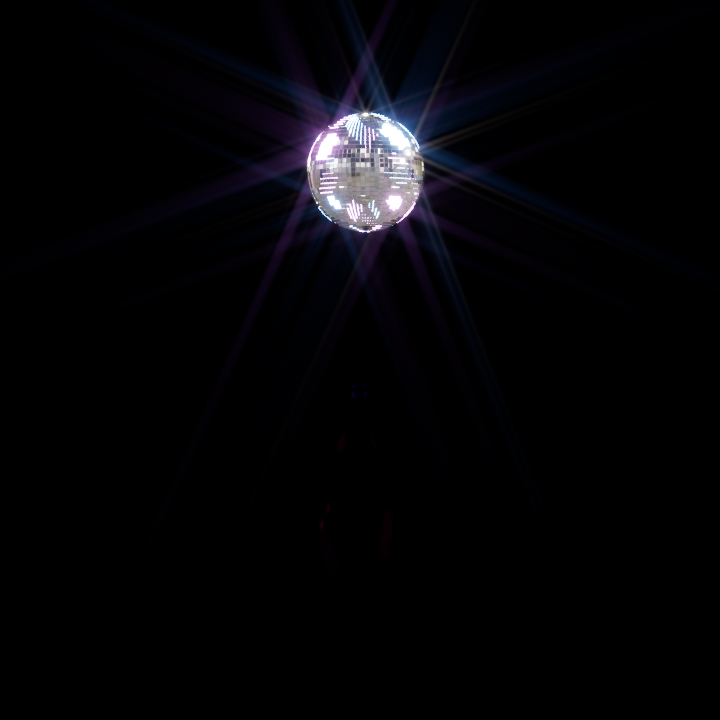

In my current project I am making a 3D poster with a disco ball and I try to replicate the effect that can be seen on the youtube video below
I tried to replicate the light beams with the Glare post effect but I'm not totaly satisfied
I also tried to add a fog volume but obviously the fog take effect on the entire poster and its not good
Here is the result on a black BG : its okay but in my poster with all the other elements the light streaks are barely visible
Is there other ways that you can think about to replicate the light beams effects ?
Maybe some fake light beams techniques ?
(I don't care about the light dots on the walls)
Thank you !

A fairly simple way to fake it is by adding a cluster of volumetric spotlights at the origin of the rays. Here I've done it quickly with a cloner, but for more control, you can place them individually. Some depth of field would also soften the near edges of the rays.

Thank you ! It is a great idea, I tried it, it works but I cant seem to have much light at the base of the cones like in your picture.
Also the light does not take into account objects that should "break the cone" of medium light.
Anyway I need to render an animation and I think it will cost too much memory so I'm still gonna try it and we'll see.
I know that I have to make choices haha I can't have everything at the same time.
I tried something that quite works too with the Glare post effect I just put a little square area light, onto the disco ball, shining directly into the camera and it makes great and powerfull glares.
Thanks again for the great tip !
