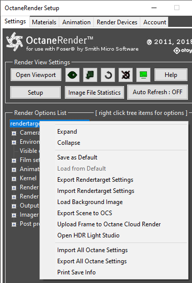

face_off wrote:
Maybe at one point, the OR devs switched up this system, and I just didn't catch it =D
If you rightclick the rendertarget and "Load from Default" does it fix the issue?
I can't, as it's greyed out for me. Looks like I don't have a default RT file.
Saving a default file is possible.
Erick
Posts: 245
Joined: Thu Sep 13, 2012 9:40 am
Re: OctaneRender 2023 for Poser [TEST and STABLE]
Postby face_off » Fri Mar 08, 2024 5:40 am
face_off Fri Mar 08, 2024 5:40 am
I understand. I think this version should resolve the issue. Can you please confirm?
https://render.otoy.com/customerdownloads/plugins/5f/40/cf/0b/OctaneRender_for_Poser_2023_1_2_123_STUDIO.exe
Posts: 15493
Postby Erick » Fri Mar 08, 2024 7:23 pm
Erick Fri Mar 08, 2024 7:23 pm
face_off wrote:I understand. I think this version should resolve the issue. Can you please confirm?
Looking good so far.
Render AOVs -> Render passes are all visible again.
Thank you for the support! :)
