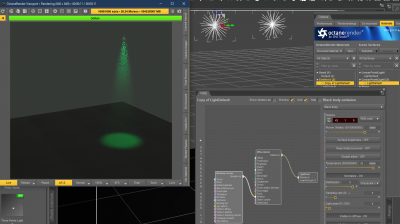

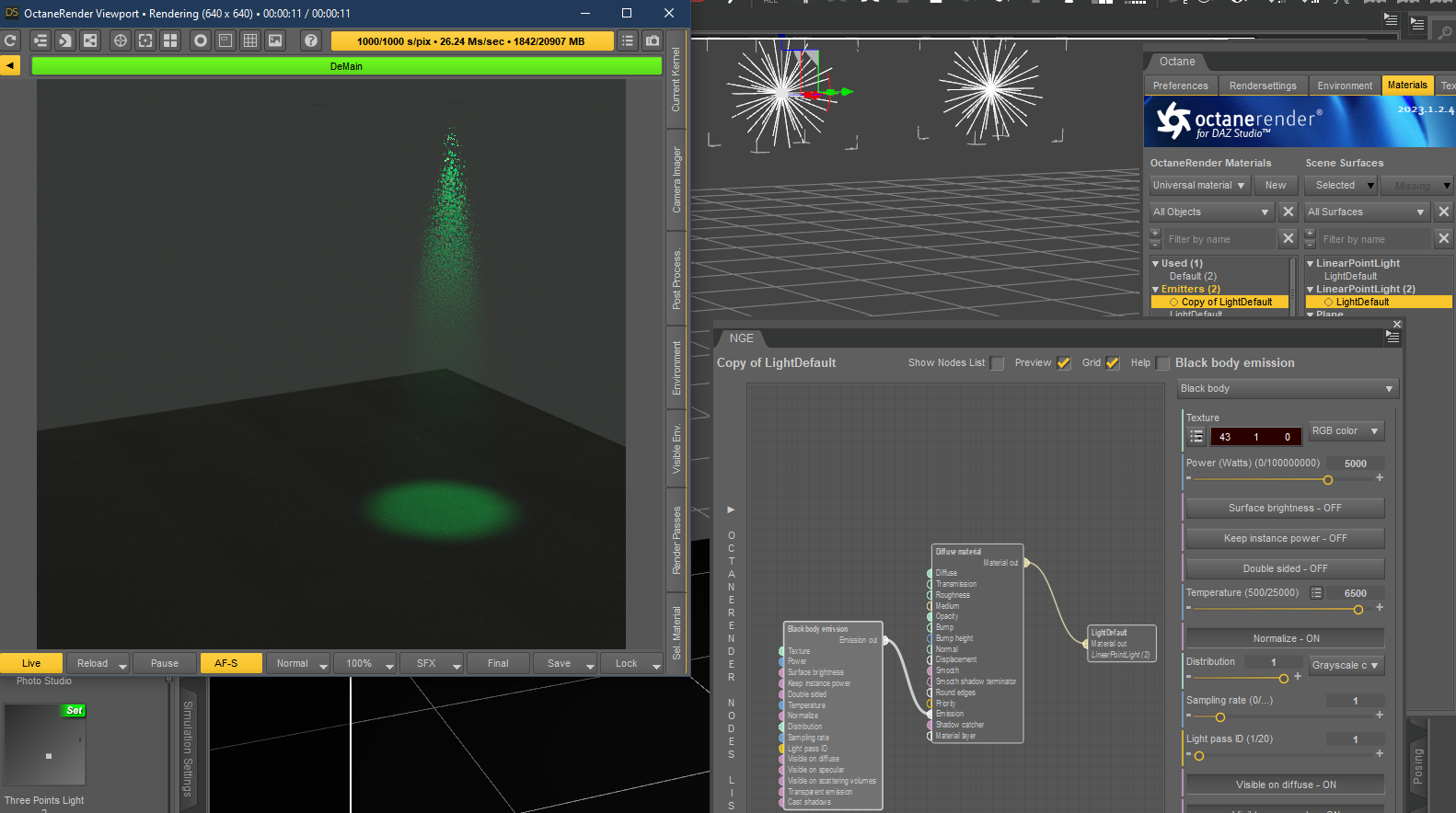

I think I found a way to reproduce the steps.
1. Create two point lights and a plane (I set mine to roughness=1)
2. Set the Light Geometry to Disc (I didn't test any other)
3. For the first light, in the Octane tab, right-click the light surface and create a new light source
4. For the second light, copy the first light shader and assign it to it : The second light turns off
5. Still on the second light, create a new light source : The second light shows correctly
I hope it helps.

I just right-clicked on the emitter and copied as new material, just like in your image. I can even reproduce the behavior with a single light, just set it to disc/rectangle, activate analytic light and create the simple light source and copy it.
UPDATE : in the copied light shader, if I disconnect and reconnect the emitter node to the material node, the analytic light displays correctly.
I was able to repro, will look into it. Thanks for reporting!
