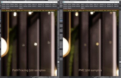

I have made an interior that has lots of lights and some reflective surfaces. Problem is that whatever I do I don´t seem to get nice clean reflections. Light reflections are all pixelated and bad looking. (See attachments.)
I used the wine glass spot as an example.
I think I have good render attributes but maybe there is something that I dont know about:
1. Wine glass is well Subdivided (200.000 polys)
2. Hot Pixel visibility 20%
3. Path Tracing
4. Max Samples 8500
5. Diffuse and Glossy depth 26
6. Caustic blur 90%
7. GI clamp 10
What should I look next?
