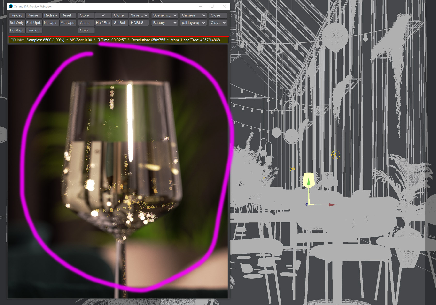

Postby Builtdown » Fri Jan 12, 2024 9:39 am
Builtdown Fri Jan 12, 2024 9:39 am
I would need some tips.
I have made an interior that has lots of lights and some reflective surfaces. Problem is that whatever I do I don´t seem to get nice clean reflections. Light reflections are all pixelated and bad looking. (See attachments.)
I used the wine glass spot as an example.
I think I have good render attributes but maybe there is something that I dont know about:
1. Wine glass is well Subdivided (200.000 polys)
2. Hot Pixel visibility 20%
3. Path Tracing
4. Max Samples 8500
5. Diffuse and Glossy depth 26
6. Caustic blur 90%
7. GI clamp 10
What should I look next?
Thanks!
Builtdown

Postby elsksa » Fri Jan 12, 2024 12:44 pm
elsksa Fri Jan 12, 2024 12:44 pm
These are unresolved sample areas, Adaptive Sampling seems to be missing from the listed settings and I assume, is disabled. Enabling it will tremendously help.
Another parameter is the ray depth, despite being scene dependant I would assume it's too high.
I strongly recommend to thoroughly consult this Octane Sampling Guide which pretty much answers almost all sampling questions.
I will reply on your other forum post but be aware that it isn't necessary to post twice as we end up seeing twice the same posts under "new posts".

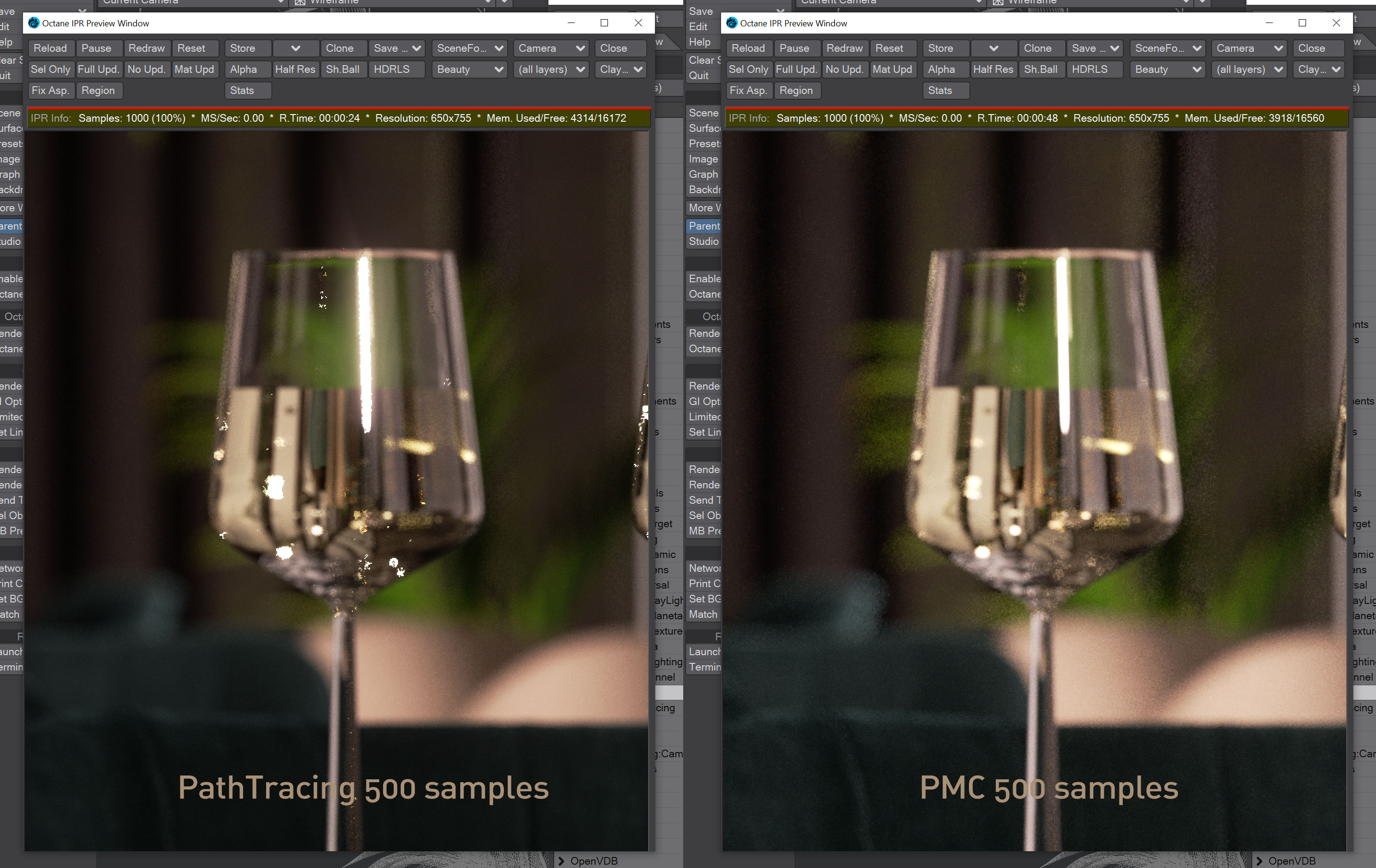

Postby Builtdown » Wed Jan 17, 2024 9:59 pm
Builtdown Wed Jan 17, 2024 9:59 pm
I still think I did everything right and no bokeh map.
But good that you mentioned changing kernel. Because that was what really worked!
PMC kernel did exactly what I was looking after. I have never used PMC with interior pics but now it seemed to be the answer.
I attached some examples with bad PathTracing result and PMC result with approx. same time rendering.

Postby elsksa » Thu Jan 18, 2024 6:20 pm
elsksa Thu Jan 18, 2024 6:20 pm
That's great looking, indeed. Glad it helped.
The practicality of Kernel choices in Octane. PMC also helps with volumetric scenes and Photon Tracing principally with caustics.
Comes handy when needed.
