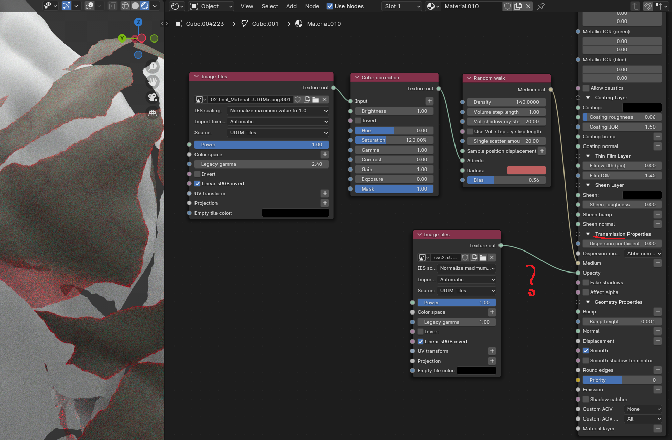

Hello, can anybody help? where to add sss map? every setup that i tryed didnt worked...
I have just 1 mesh and half has sss and other half doesnt. I know i can split this mesh into 2 and do them separetley but it must be the way to just add sss map somewhere there
please help, :? :( :roll:
thank you!

There are no input for sss map in medium nodes. You can use the map as mask factor between sss and non sss material for example..... or use it as a mask for mix texture for radius input in Random Walk node.

J.C wrote:There are no input for sss map in medium nodes. You can use the map as mask factor between sss and non sss material for example..... or use it as a mask for mix texture for radius input in Random Walk node.
i tryed, it didnt work :|
is there any way you can please send example in your screen picture how to connect it :cry: thank you!

As pointed out, the SSS map goes wherever it works best. Nowadays SSS is more advanced, there is rarely only one SSS map but several for different attributes of an SSS shader. For more in depth details on SSS perhaps this SSS page could help.
What's the asset? An organic character, plant or artificial object?

just put your bw sss mask into the transmission socket... that's all

kabakZ wrote:just put your bw sss mask into the transmission socket... that's all
i try everything and didnt found in transmission menu, where to add sss map =(
is it even possible to add sss map?
