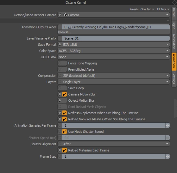

Your hint with the Imager settings in Modo led my to the right place and I found the culprit!
In the Imager settings of Octane in Modo there are two different sRGB settings: "None (sRGB)" and "ACES: sRGB" – those are NOT the same!
I had the former, but need the latter.
Once the view transform in Modo is set correctly to the same I have in Nuke (both "ACES sRGB") all is good!!!
Now this workflow works as expected:
- Display the image in Modo with a specific view transform (Imager settings OCIO View) - e.g. "ACES sRGB" (if that is the appropriate for your monitor)
- Save the image in any file format in any color space
(can be PNG with "Output - sRGB" or an EXR with "ACEScg", or...) - Load the image into Nuke and set as the input transform in the reader node that very same color space
(that way the data get's "decoded" and transformed into Nukes internal color space) - Make sure your viewer transform in Nuke is set to the same as the Imager OCIO View setting in Modo/Octane
Then everything is peachy
