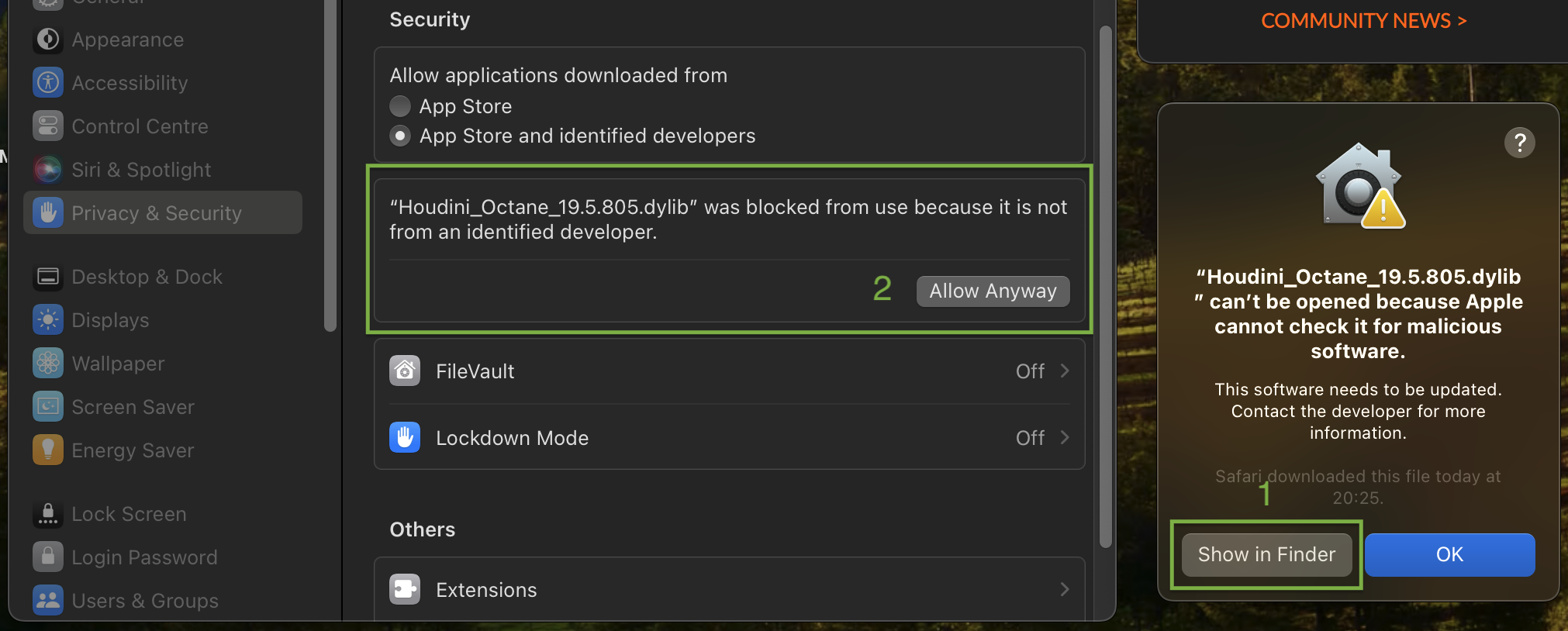

Ok had a look again and got the same error when clearing permissions. This is an Apple permissions thing so please try the following.
Step 01: Control + right-click then choose "Open" on the file liboctane.dylib under the octane plugin folder dso.
Step:01
Step 02: Click "Open" on the dialog box then start Houdini.
Step:02
You would have probably also see the file appear under your Privacy & Security Mac settings.
You could also try this on the Houdini_Octane_20.0.506.dylib if the first one didn't sort it out. Let me know if that helps :)

If restart and try launch Houdini again, do you get the following popup? When you do 'Allow Anyway' under security you would have also needed to add your Mac user password to give proper permissions.
Click Allow and Enter your password. Then Launch Houdini again.
If permissions aren't added you will get those errors from your first post - example below.
