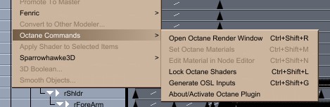

Maybe, if you have not already,
Look at the top ribbon for:
Edit>Octane Commands> About/Activate Octane Plugin
About/Activate Octane Plugin should not be greyed out. If it is, you may be able to activate by clicking on it.

Postby protovu » Wed Jun 30, 2021 4:24 pm
protovu Wed Jun 30, 2021 4:24 pm
Here is how mine presents. Maybe refer tech support to this image, and your image of same?
