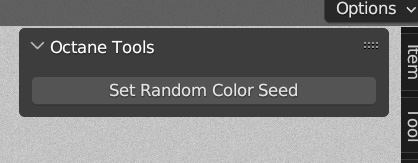

After installing, you should have a button in the flyout menu on the right. Like that ...
After that just select all the objects that you want to randomize and click the button of the addon. You will not see the changes immediately. Not sure how to refresh the scene from within the script. But just start to move the objects by hitting "G" and abort it by hitting "ESC". After that the objects should refresh and the randomization should be visible.
Hope that helps.
