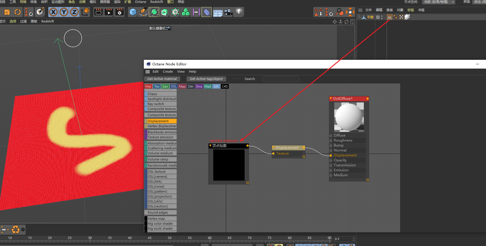

Postby zyd-1990 » Fri May 13, 2022 6:55 pm
zyd-1990 Fri May 13, 2022 6:55 pm
How can i use Vertex texture to displacement? It doesn't work when I do this.

Postby bepeg4d » Mon May 16, 2022 7:25 am
bepeg4d Mon May 16, 2022 7:25 am
you can use the Vertex Map into a c4d Displacer deformer:
