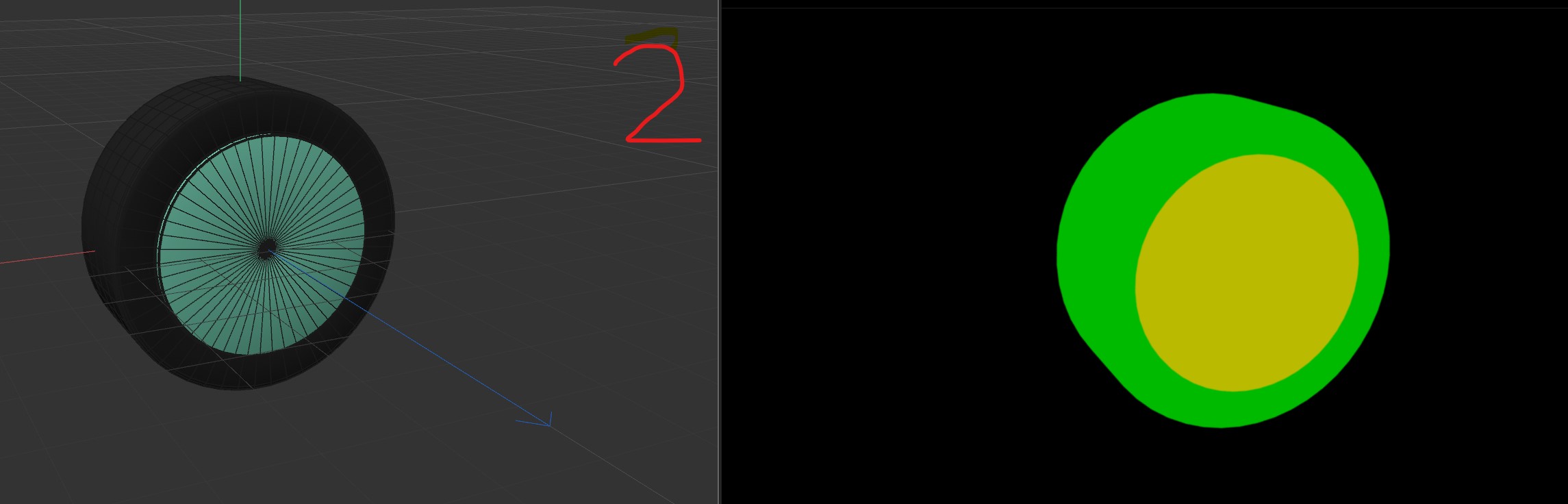

I am working on setting up a pipeline for ML training with synthetic data sets generated with C4D and Octane.
The beauty shots are all good but when I need to go and set up a the INFO passes as AOVs I have an issue.
I'm masking out some parts of the geometry, in this case the wheels of a car, with a simple geometry on top of it that is not rendered out on the beauty pass by setting it's layer ID to a different number. That enables me to have the beauty pass, without any other masking geometry visible. (See image 1.)

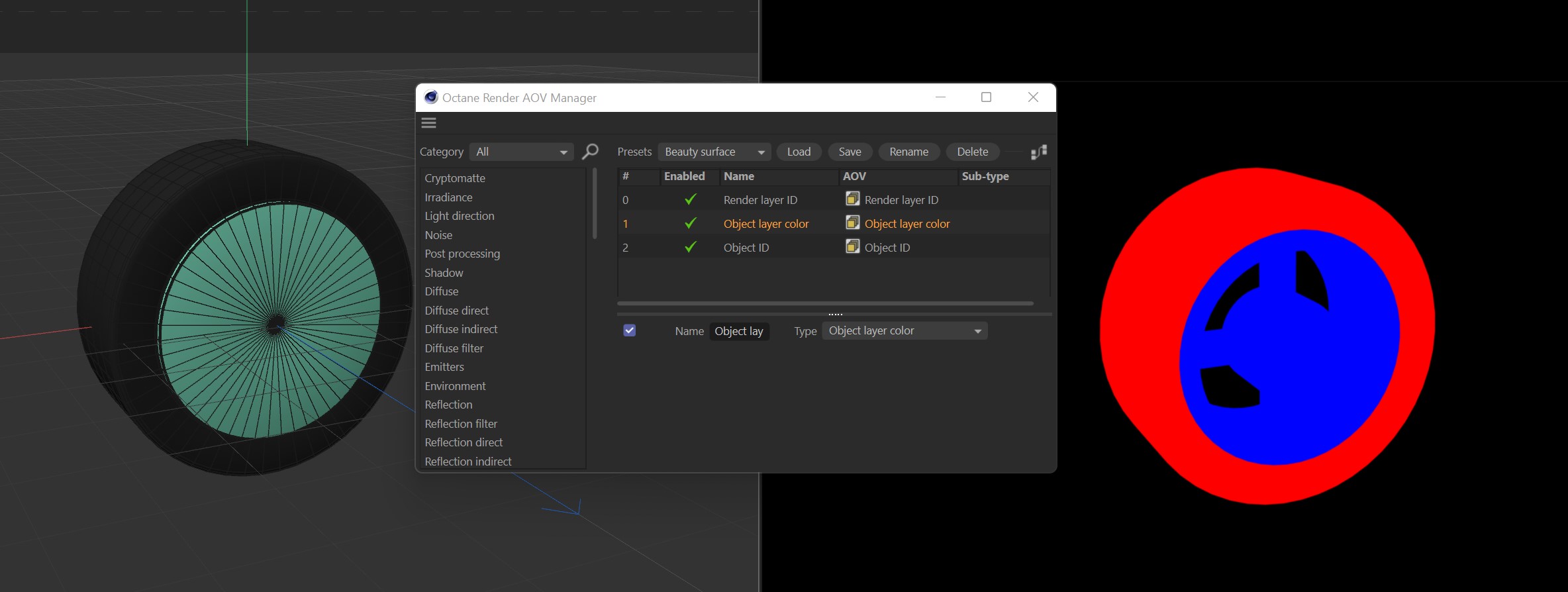

When I add the object layer ID to the Render AOV group as a separate layer, all the geometry shows up color coded as it should, which is great. The problem starts from there. I don't have an obvious way to control the color of the Object Layer ID (see image 3.). It seams it's generated internally and I need to figure out how to assign a specific color (designated by the ML research team)to each layerID. (see image 2.)

I'm not sure about the specifics in C4D but in standalone there is a Render AOV named "Object layer color AOV", under the Info category. This renders the object in the color you set in Object layer > Color.

It is available and it would do the job of customizing the color, but it doesn't solve the visibility problem. I need to have a beauty pass without the masking objects visible and an info pass where some things are occluded for the AI to group them into one label. That means I need the whole rim of the wheel to be occluded without any transparent parts or objects with other labels visible through it.
The Render Layer ID solves this pretty elegantly as I can add different label groups to a new Render layer and not worry about having them rendered in the beauty pass. The only thing missing is a way to assign a color to those layers. A checkmark that says Use Display color would solve the problem. Not sure if it can be scripted in somehow or add some custom node that can pipe in the desired color. I'll try to figure out other methods as well but if I can't solve this, ultimately I might need move on from Octane as solution.
I have added a screenshot to show the result of the "Object layer color AOV"

Would this work: render the scene once on render layer 1 (normal geo) and save the beauty pass, then render the scene on render layer 2 (proxy geos) and save the Object layer color AOV.
Solution 2, simpler but maybe there are too many objects: don't use render layers or proxy objects, go into the object layer of each part and assign the color corresponding to its category. Then save beauty and object layer color.

I don't think it will double the render time because the proxy objects should be very fast to render. You can even use the Info channels kernel for this, it has the object layer color mode, and very few samples per pixels, maybe even 1 spp.

Another solution that might be closer to what you are trying to do: use a null material on the proxy objects. This way they won't show up in the main beauty render, but they will still show up in the Object layer color AOV.
In this case there is no need for render layers, you can save the beauty and the segmentation map in one render.
